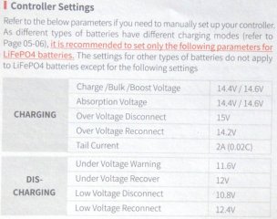

FYI.. answering may own question here after a little testing…
using a cheap ($20) , 20a , solar controller, and feeding it the 14.4 volts of alternator output into the solar input terminals, it charges my LifePo4 ,12v battery at 15 amps.👍
and yes, these cheap solar controllers do have a LifePo4 charge profile setting .
Now i wait to see if it can fully charge the battery ?
Edit/update…. Charger cut off at 13.6v at the pack,..which the capacity meter tells me is 98% !
All good, but that was running the 14.4v input from a power supply.
Next test will be the real thing from the RV alternator 🤫

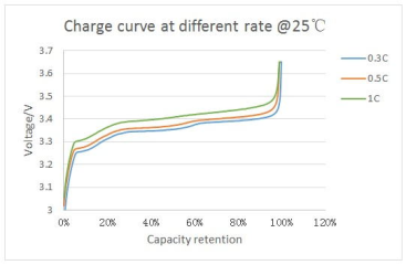

I would NOT try and push the batteries that far myself and I have been living off grid with solar and batteries for 17 years. If you really want to get the most life out of them. You only want to fully charge them once every few months. Do a little research most people go with a basic parameter of roughly 25-75% or 20-85% state of charge no lower or higher other than the occasional balance charge. That's for maximum battery life to the best of my knowledge with LifePO4 cells and I've got a lot of them! I actually tend to run mine a little different @ 30-85% state of charge.

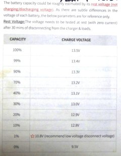

How Do you guage those 30-85% limits, ?… by voltage, or capacity (wh) monitoring ?
The battery bms has low voltage cutoff and overcharge protection (13.6v), so some form of external charge voltage limiter would be needed to keep down to that 85% max level (13.35v ?)
Page 9 from my Li-Time manual 12V 100Ah LiFePO4.
There are obviously differences between brands.
My DC Mont 135 ah battery lists 3.6v resting voltage at 100% capacity, and there is a “%” readout on the pack that corresponds .
but i have never confirmed that 100% is actually 135 ah ?
Also 30% capacity is stated to be 12.9 v,…but again i have not verified that figure.
It is a little worrying in that 0.1v can be more than 10% difference in capacity.
A good enough reason to keep well away from the voltage extremes. !🤔
