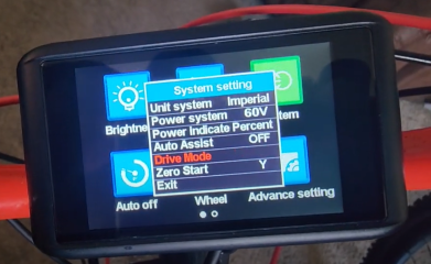

My setup is Sabvoton 7245 with ukc1 display. I have some generic twist throttle that I was able to map out the 3 pin wiring and got it to work however I simply cannot get the PAS to work. I originally have a pas with a 3 color which is red, blue, and yellow. Blue is signal, red is 5v and yellow is ground and on Sabvoton side its brown as 5v, yellow is signal and black as ground. That did not work and after I tried every combination of those wiring with no luck. I then bought a new PAS that was supposed to work with KT controllers but that also doesn’t work. Is there a specific type of PAS for the Sabvoton?
I have been digging online and I find that my display doesn't have the drive mode option like others that I see online.
First two pictures are from my display and last picture that shows drive mode is what I see on other peoples display. Is this an issue with the display or controller?

Did you buy the display and controller as a set? Displays are programmed to interact in specific ways with individual controllers.
The display pictured by others is installed on a Sabvoton?

Yes I bought the controller and display as a package but I bought it from AliExpress.
So far I have no settings in my display for pas settings other than assist level. I always thought there should be a setting to set as either throttle, pas, or both but those settings are missing. Could it be that I got the wrong display that is made for a scooter and not a bike? I see there are two different kind of sabvoton. One is svmc and the other is svmc-m that have pas. I have the correct svmc-m and it does have a labeled pas connection.
Take a closer look at…
Assist poles.
Throttle level and,
Clockwise start.
Reference manual that seems to have better than most descriptions, but still poor.
https://enduroebikes.com/wp-content/uploads/2023/02/UKC1-TFT-Color-Display-Newer-Version.pdf

I have two pas sensor one with 6 magnets and one with 12.
So now I have it set at assist poles 12, throttle N and clockward start N. (What I had in screen was a desperate attempt to try something that I havent tried)
My pas sensor does not have indicator lights and I have tried cranking both forward and reverse.

Final update, the pas that have wiring color black, yellow, and brown works! I thought all pas sensors were more or less the same just maybe different wiring configuration but looks like I was wrong
