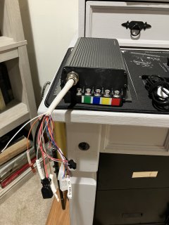

I purchased a Sabvoton SVMC 7280 (M) from ebay (new in the box). 66 bucks so I thought hey, will learn on it and figure out how to program with and test my new 3000W-5000W QS205 that is slated for a build soon. This is my first experience with Sabvoton (I am a Grin guy all the way but they do not have larger more powerful controllers). Got the bluetooth and the USB for PC. Hooked it all up to my motor got both the bluetooth and the USB going and reading the controller. Did the Hall test and it indicates "test ok" but there is NO throttle the motor will not move nor does it even try. It is as if the throttle is locked out by a setting that totally escapes me after hours of trying. The controller hall plug plugs into my QS205 perfectly with all wires matching. There is no screen plug on this controller at all. It has a 3 speed switch mode, 5V throttle wire, 12V high brake wire, white reverse wire, red and black with 5V and some alarm wires. I turned off all ebrake functions and regen functions and still can not get the throttle to work. (The motor works on my Grin Phaserunner) Am I missing something?

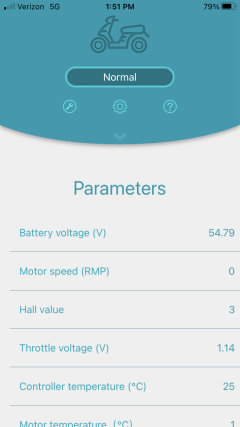

Throttle gets the 5V as a matter of fact you can see the throttle voltage go from 1.4 to about 4.5 on the phone app and on the PC interface. It goes up and down with the actuation of the thumb throttle. I do an auto learn test each time I fire it up. It does a very slow spin then indicates that the test is "ok". I have programmed all of the battery info and cutoffs into the software.....turned off everything that I can possibly think of that would lock out the throttle....to no avail. It ran on my Phaserunner...go figure!

I think this alarm wiring is keeping my motor locked out…i read in the manual that when anti theft is active the controller kicks the motor but not the actual throttle signal which explains why is see it working in the software but the motor won’t move. How do I disable this function?

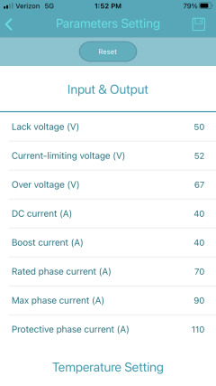

Here are some screen shots of the app.
I'm pretty sure there are more settings than those, in the sabvoton setup program(s) (vs the app); you'd have to look around to see what is actually available for your specific model. The app screens you show don't show any of the inputs, what they are for or what their states (or expected states) are, and since tha'ts what you need to know or be able to change, the app you've got is insufficient (assuming that's what the problem is).

If it's not plugged into an alarm system, then it's not enabled. Did you try swapping the blue and green phase wires in the pic, and seeing if there's movement when you twist the throttle?
Yes the controller won't even power on without an alarm code when I do that.
If it's setting off the alarm when changing phase wires, then it sounds like it's really wired wrong. The alarm should have nothing to do with the phase wires; that should only be the ones in the "alarm cable".
Swapping phase wires should just change motor direction (when done along with the corresponding halls if it was already working correctly. If it wasn't, then swapping them is the start of the process of determining which order to connect the wires for phases and halls to get the motor to spin correctly, when autolearn doesn't work or isn't available).
Those learning functions don't always work, and a quick phase swap could rule out, or in, other issues masquerading as a throttle problem.
Using the flow chart, the "stuck" motor only takes 3 combinations of phase wire swaps to test before the motor spins smoothly; if it's going the wrong direction, then you swap hall sensor wires.
