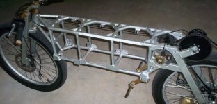

Downsizing
I'm in the process of downsizing my batteries from the older 38 Ah size to the 18 Ah size and this will require the creation of a new insert that will hold the smaller batteries in the larger cube. So a little fiddling around is in order.
The new configuration will be four 18Ah SLA batteries running at 48 volts and 40 amps... that is unless I feel like trying out my 100 amp controller... we will see. The 100 amp 48 volt controller is supposed to go on #002 as it is going to the fastest bike of all of them.
So I'm going from about 86 lbs of batteries to about 52 lbs of batteries... a savings in weight of about 34 lbs, so this will seem a lot lighter afterwards. Less range, but what it will do it will do really fast. :)
Why would you need a new insert? Two normal-sized 18Ahs (1/2 U1s) are almost exactly the same size as the 35Ah U1s you were using.
Two 18 Ah cells do indeed fit into the space of one 38 Ah cell and I could leave one open for cargo space... at least one MIGHT try something like that if they were unaware of what a "stressed member" frame design is about. In a "stressed member" frame design the battery is supposed to assist the frame from flexing... it's actually supposed to add stiffness. This is in part why such a relatively light weight frame has been able to withstand the speeds and forces that it has because it's a unit that works together.
So I have no choice... I really cannot leave a cell space completely open. Instead I'll be placing two cells into the front location and then one in the each of the back two. Then I'll get most of the structural support that I had before.
Pictures will follow eventually...
The frame will not be "chopped", I'm simply adding a little tray that will allow the back two batteries to be centered in their cubes. It's like adding an adaptor, the frame will still be able to run 38 Ah afterwards if I wanted to switch back for any reason.
file.php
I would be amazed if that frame flexed very much even without the batteries. The only point I can see for weakness is the rear arm. You have the main frame trussed up pretty well.
I've replaced the last of the heavy 38 Ah cells and have built the little battery trays to make the smaller 18 Ah cells fit nicely. It's been two days of fabrication to get this done... I'm pretty tired. :|
The lighter weight and the fact that I now have four new batteries (well two of them have about 500 miles on them) means that I'm able to go faster EVERYWHERE and it's kind of impressive. That 34 lbs really makes a big difference on the hills and now I can pull taller gears in places I never imagined. The bike has again been transformed.
Four 18 Ah SLA's seems a nice "sweet spot" as far as a configuration goes. Any more than that and the weight becomes so much that parts want to break, but now it's so light I can actually lift it up. Only 52 lbs of batteries means that the whole bike is now down to a little over 100 lbs.
