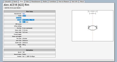

I am just wondering if the Alex Ace-18 rim 700c is a half decent rim?
Looks to have some decent depth by the looks of the 26" model.
Must be an older model as I dont see it on the Alex site.
https://alexrims.com/product-category/wheels/road-wheels/
I need machined sides.
This is for the rear with no hub motor, and to put the bike back to stock requiring 2 rims to be purchased, plus a spare or two so 3 to four Ace-18's rims.
The stock bike hubs are 32h :thumb:
Reviewer says "The width is 16.5mm inside and 21.75mm outside of the rim."
So what rim tape should I get, 15mm?

Just went back to where I bought it from to get the regular non sale price and its no longer available with no price attached anymore, so its old stock. I can always return some to the store, or sell 3 of them. I also can not find the E.R.D. and I cant find much info plus I cant find anyone else selling them. With 32 holes I can have the lbs cut the spokes, I bought some a few days ago because I broke 3 while riding and the bikes wheel I was riding at the time (not the one I am building back to stock) went real wobbly. That same lbs had a cassette, rim brake completed wheel for a hundred bucks.

I clicked on it to give you this info
ERD 560
Spoke count 32
edit
Alex ACE18 [622] Rim

No you don't. You only need rims that have a brake track; they don't need to be machined. That feature is for the convenience of the manufacturer, not the end user.
Alex ACE-18 is a pretty small rim for a big boy.
The overwhelming majority of hub motors are drilled for 36 spokes, not 32.

Chalo - Do you recommend a spoke tension gauge tool, I bet you dont your too old school. Me too :thumb: but I aint as smart or knowledgeable or handy as you. Brake track is what I meant, I just did not know the name. Tthe new Alex Ace-18's will be laced properly with good components and thin spokes doing it all properly, de-stress and I bought some boiled linseed oil. But thanks for correcting me to do a bit of web searching and learning a bit. When I read machined sides I had always thought that it just meant rim brake track, but I was wrong yet again. Thats whats so great about this website is what I have learned. https://www.cyclingforums.com/threads/rims-machined-vs-non-machined-sidewalls-any-real-difference.2388/
I still cant find any info at all on the Alex Ace-18 rim, no E.R.D. info, no info on if its pinned/sleeved/welded. Be good to measure it all for the rim and hubs.

This is a picture for a 26" Alex Ace-18 rim, its a deep rim which is what I like.
I use the Park TM-1 tensiometer mostly. It's not especially accurate or consistent, but it's easy to use quickly, and its measurements are good enough for the job. I have a DT Swiss Tensio, but it's slow and fiddly to use, compared to the Park version. It's also expensive unless you amortize it over a huge number of wheels.
I used to rely on feedback from the rim to tell me when spokes had become as tight as they could reasonably be. But there are some rims (Mavic as one example) that don't tolerate overtension well at all, so now I'm in the habit of looking up rim specs and taking measurements.
$90 ouch, but quality tool compared to the cheaper, not as accurate Jagwire tension tool at 1/3 the price.
For a local bicycle shop, would those guys use one or would it be more personal preference and a coin flip on whether they had one or not in the repair shop?
Spoke tensioning tool wouldnt work if you had too short a spoke. I use 26 on leaf 35h 1500w, think spokes are 168mm, so I wonder what the shortest spoke you could accurately measure with a Park Tool tension tool.
I'm not familiar with that one, but I notice that you can get some no-name clone of the Park tensiometer for about $25 on A**zon. Not super trustworthy, but probably good enough for the home workshop.
The DT Swiss Tensio I was taking about retails for $600 now, though I think I remember paying $240 for mine around 20 years ago.
