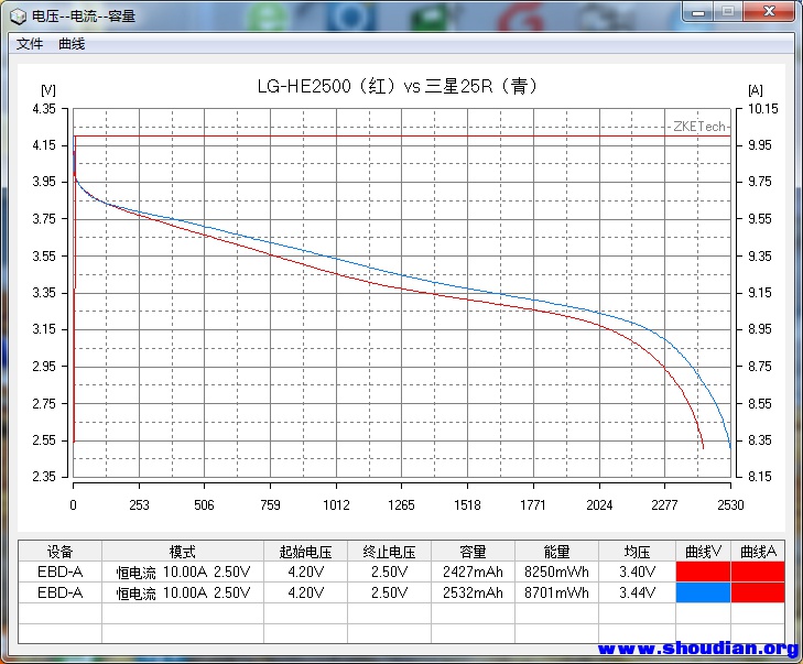

Check out this thread on a chinese forum.
http://www.shoudian.org/forum.php?mod=viewthread&tid=391456&extra=page%3D1%26filter%3Dtypeid%26typeid%3D1&page=1

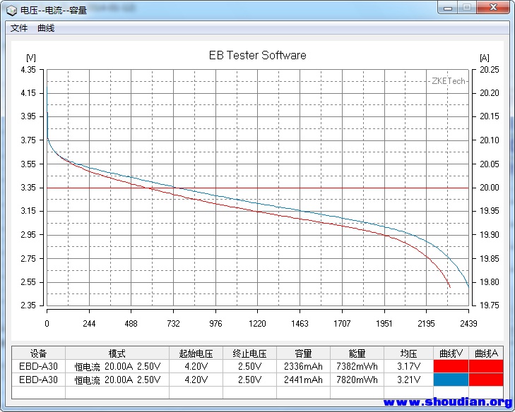

They tested the samsung and LG cell at discharge currents up to 30A. The samsung cell has the edge in terms of capacity. Both get quite hot at 20A and are scorching at 30A. Couldn't see the curves though, even after I registered.
Ok I can see the graphs now. Had to wait 24h for my account to get approved or something.

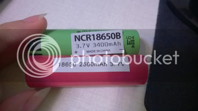

I just got a quote of 4.3usd each LG 18650HE2 cell for a 100pc order, confirmed that they are the 35amp version. Too good to be true or some kind of catch maybe? They seem like a legit company on alibaba, linked below. I also inquired about panasonic 3.4ah cells and they sent me a picture of them with a made in china sticker, from reviews I read they stated made in Japan. Lower quality maybe?
http://listman.en.alibaba.com/product/853047264-218773810/Panasonic_3400mAh_NCR18650B_3_7V_protected_rechargeable_li_ion_battery.html
Like many have said on endless-sphere before me when you head over to alibaba you really do not know what you are dealing with. There are many accounts of forum members and others alike that have gotten burned and recieved factory defect cells, or just fake ones altogether. And if you want to use the HE2 battery to discharge at 35A per cell you just flip a swith called self destruct mode. In all honesty the HE2 and 25R get ridiculously hot at 20A discharge when you discharge them to 35A you are just torturing your cells and allowing cycle life to decrease substantially.
