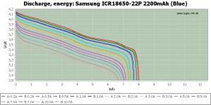

Are these cells decent?
Samsung ICR 18650-22p cells 2150ma
Was considering ordering some as I can get them for really cheap at the moment. Not sure if any of you have used these and can share your experiences. These cells I’m considering were made in 2020 but they’re still brand new in the box.
Can get 100 count box’s for $100. So at one dollar per cell is super cheap. These cells can discharge 10a Continuous and burst 17.5amps for 4 seconds. Was thinking about using these for my bomber frame build. Wish they were at least 2500mah but they have decent discharge rating, especially being at one dollar per cell.
I would greatly appreciate if someone could comment on these cells! It seems like a great deal, just don’t know what the track record is on these Samsung cells.
Don't know myself, but here's some info from a testing site:
Thanks! I found my answer my reading one of the post on the graveyard search.
Looks like this 10 amp continuous discharge is way overrated.
