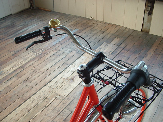

What kind of handlebars would you replace them with?

At my bike shop, we replaced the giant goofy crescent shaped cruiser bars on our rental bikes with Wald 867 bars:
These are very cheap, widely available, and provide a cruiser style riding position without rendering the rider helpless and awkward. Plus, they're still made in the U.S. of A.
I have also retrofitted many cruisers with BMX bars. Those allow a very upright riding position, but with much more authoritative control of the bike compared to pulled-back cruiser bars.
You have to take care to get bars that have a long enough straight section to support all your handlebar mounted stuff. When that's in doubt, I use CW style bars that allow more mounting options than any other BMX bar.
Thank you, that's extremely helpful. I'll plan on swapping the handlebars once I have the bike.

I have ridden my Townie with them C-style handle bars, and I did not like them one bit. It wasnt like it was straight on (RH @ 6 oclock) but something from 5 o'clock (RH). I find I like a slight angle in.
Yes
https://www.niagaracycle.com/categories/xlc-city-trekking-handlebar-59-degree-610mm-25-4-silver
Below = NO
https://www.niagaracycle.com/categories/hbar-sunlt-crsr-dno-33wx6hx7-8bk
Most awkward of all
https://www.niagaracycle.com/categories/wald-867-low-rise-cruiser-bike-handlebar-20-inches-wide-chrome-4-inch-rise
