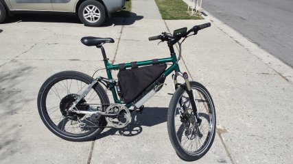

After a year of owning an Aipas 2,600+ miles on it. I know I really like eBikes. I want to build a bike from scratch now. I have welding experience and plan to fabricate my own frame and build it all up from parts and materials including the battery pack. I have formerly been thinking in terms of how big of a pack can I build (for long range) but recently realized that a better approach is build a moderately sized pack and set it up for fast charging. If I can charge the pack most of the way in about an hour that would be kinda ideal really. It would keep the bike lightweight, less expensive to build the pack and an hour or so isn't a big inconvenience. Could be getting lunch, shopping etc. while charging.
The bike I want to build is probably more a lightweight motorcycle than a true Ebike (with pedals)
The idea is a supermoto type bike running 3" street tread tires mounted on double wall 24"x4" wheels. Like a Stealth Bomber almost but using an in frame motor instead of a hub motor and different wheels/tires. 20-30mi true range and 50mph would be excellent. That's all I've got for criteria at the moment.
I figure this thread can be for discussion of everything pre build including recommendations/discussion for electronics like motors, controllers, and battery cell types.
You need to decide what voltage you'll be running. For 50mph, you'll need 72V minimum, but higher voltage may run more efficiently, but the cost of the controller goes up quickly for voltages above 72v. 50mph requires around 5kW.
Using the Grin Simulator, and choosing a random high power motor and adjusting to meet your requirements to get an idea of the power and torque requirements, the bike's performance should look something like this for 50mph capable, and 30 mile range. You didn't specify whether you needed 30 miles AT 50mph, but that's what is currently modeled. You'd have twice the range with the same system, if you controlled you throttle hand and didn't need to ride 50mph for the full half hour.

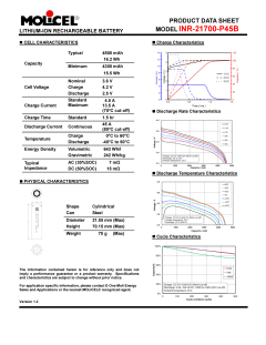

For a battery that big, there are a few option (EV batteries, etc.) but for the common cylindrical cells, the 18650 and 21700 cells are most common. The 21700 has higher capacity, so less spot welding, and fewer chances of screwing up. The two cells models below have a really high charge rate for lithium ion cells. The Molicel batteries have a good reputation for higher output and high capacity applications. You could go with other name brands (Samsung, Panasonic, LG, etc.), but not many have the ability to charge fast.
The P45B have a capacity of 4.5Ah, and the cells charge at 4.5A standard rate and 13.5A for fast charging, so a pack constructed with these cells can charge in 1 hour from dead to full at the standard charge rate, and 20 minutes for fast charging. I'm using these in one of my packs, but only charge at 8A to baby them, but for my daily riding it only take me an hour to charge up (8Ah) for a ride, and an 8A charger is still pretty compact if I want to put it in my bag. It's a 4P pack, so maximum charge rate would be 54A (that would be a huge charger lol), so at 8A, I only see about 1.5C degree temperature rise while charging.
The P50B cells have a capacity of 5.0Ah, and the cells charge at 5.0A standard rate, and 15A fast charge, so like the P45B cells, full charge in an hour at standard, and 20 minutes at fast.
Here's a thread of one ES member building a high quality, high capacity, pack, using P42B cells (same charge rate, smaller capacity). I've been waiting over 2 years to see it completed, but hopefully sometime soon.
In addition to fast charging options from Molicel, most of the new tabless cells are capable of 2C discharge, which should be sufficient charging in an hour. Options like the EVE 50 PL (not in full production yet, only preproduction), the Reliance RS50, the Tenpower 50XG (Supposedly will be in full production some time in November, from what I've heard), or even the 4Ah cell offerings (Tenpower 40XG, EVE 40PL, etc). Molicel options are more easily available, currently, and due to their anode construction they can handle fast charging better than other options.
There's a couple things to consider here, though.
Going off of the calculation from E-HP, 30 miles of range at 50mph would likely take ~3kwh of battery capacity. Charging that in an hour will need a 240V circuit or some other way to get >3000W of power to charge with.
Some layout options would be 20s8p for 5Ah cells, 9p for 4.5Ah, or 10p for 4Ah cells. That means you will need 160-200 cells (21700 format).
Personally I would currently recommend the Molicel P45B, on the basis of cost, unless you want to get adventurous with the RS50 or wait for the production 50XG or 50PL :)

Here is what 60mph but almost stealth looks like:
I'd move more in that direction considering the legal environment. Of the people that report getting busted on this forum, all of them had fatbike looking things..
