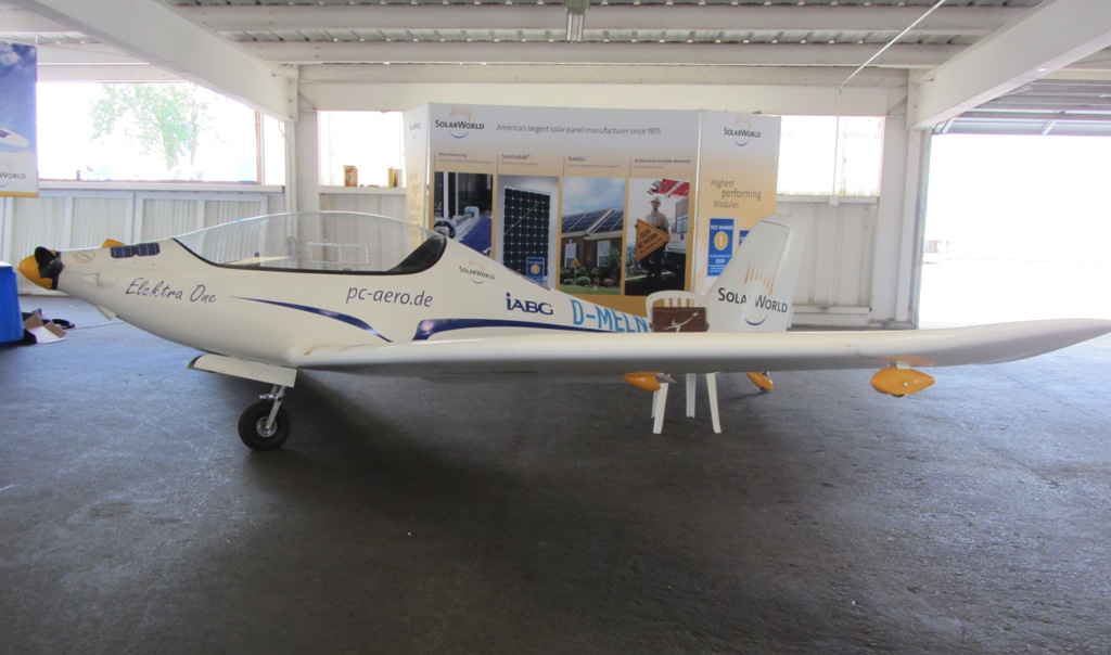

That is two seater...I recall Electra One boasted 3 kw for cruise..that is a single seater.
It has retractable main gear.
If someone made a plane using 2 kw for cruise that would be very affordable and lite weight.

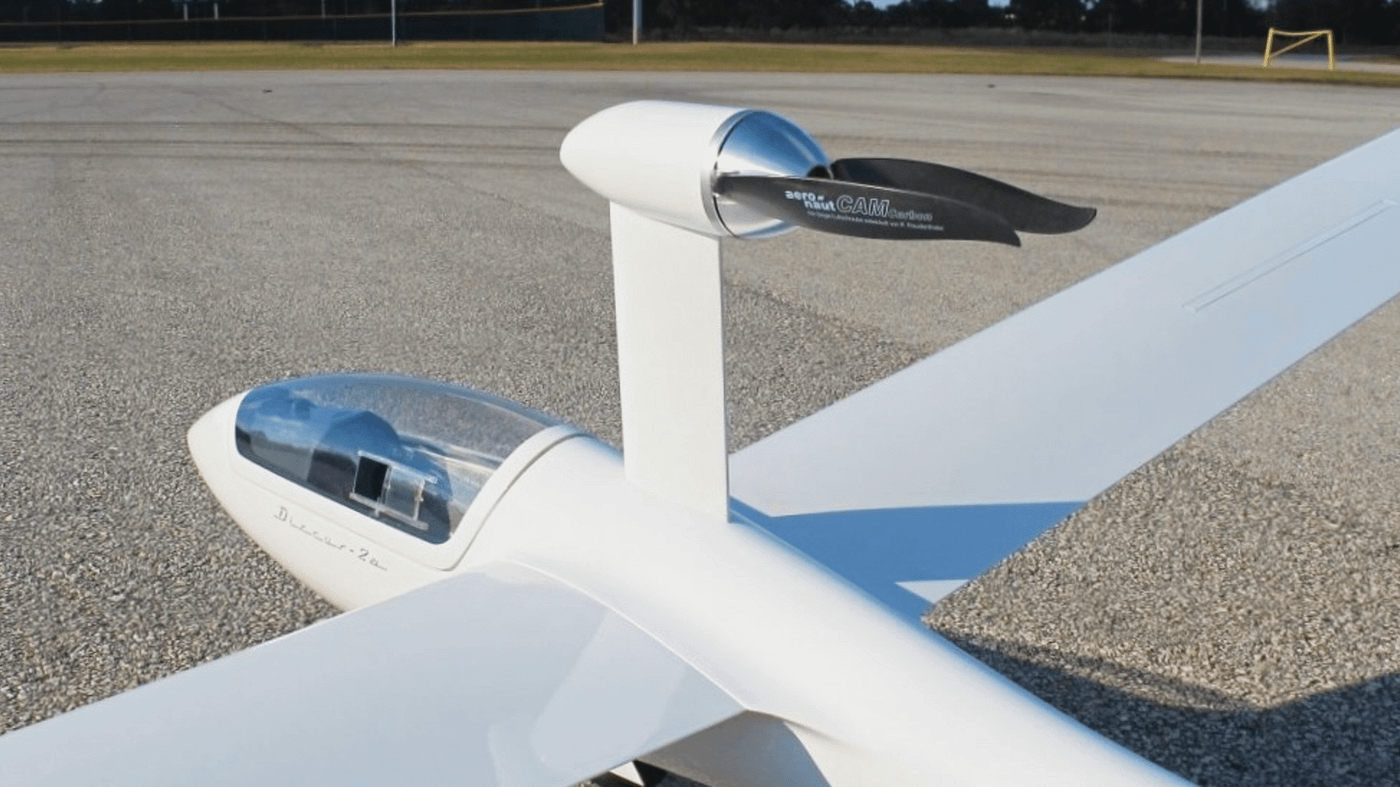

You are aware of the old 'blades fold back due to aero drag' type propellors?
The centrifugal force of spinning them and then thrust 'open' them as soon as they start rotating.
The fold away mechanism is then a simple hinged parallelogram arrangement.
Now everything stays more aero during folding/unfolding and there is no prop drag as it is only ever open after it starts spinning.

A folding prop won't fold if it is still spinning, and a prop being driven by airflow creates a lot of drag. The accident at Uvalde occurred due to an overheated controller that was unable to stop the prop from spinning. If it had been a folding prop the end result would have been the same.
I'm not familiar with said accident, but it seems to me that disconnecting the battery from the motor will stop any motor from spinning.
Are you saying that, with a folding propeller; centrifugal force alone will keep it unfolded, where airflow will keep it spinning?
That does not seem at all likely, or to be the case in any of the working folding propellers in current use.
Your assumptions are incorrect.
The airflow through a prop will keep is spinning at high speed until the aircraft is slowed drastically. In my aircraft I have to be below 70 knots for the prop to stop and that is with a big ICE engine dragging it down. An electric motor has very little drag in comparison.
In manned gliders with retractable engines the prop is positioned for retraction by operating a compression release. In electric ones they motor brake fills that role.
In addition to manned aircraft I have a bunch of large scale R/C electric gliders with folding props. The props will not stop unless you apply some kind of motor brake. If they don't stop spinning they will not fold.

I stand corrected! Thx helno.
I really thought wind resistance would overcome centrifugal force!
Ye; if you have to apply a brake anyway to make it fold, why bother to fold it in the 1st place if you can just brake is where you want it.
I do see that some spring force (or elastic bands in RC) get them folded without needing a brake though.
I wish I could find a damn video of a prop folding and unfolding FFS!
Without checking, I would guess that air pressure in low-speed (glider type) flight is insufficient to force a prop to fold against the unpowered spinning forces, unless there is a spring mechanism strong enough to overcome these forces below some speed at which the prop would never be used while unpowered.
Maybe in much faster airstreams (such as turboprop or jet craft experience?) the pressure would be sufficient, but I'm not sure. I don't have enough experience with aerodynamics / mechanics to know; just my "intuitive feel" for these things based on my limited knowledge...but intuition is not a replacement for experimental test results or knowledge from previous such. ;)

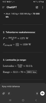

You will tend to be power limited on takeoff.
Perhaps consider a battery you can drop after takeoff? That will give you more power for takeoff, and less weight to deal to increase range and/or deal with problems.
I counted 3661 km range with 140 kg battery on a 70 kg empty aircraft design.
