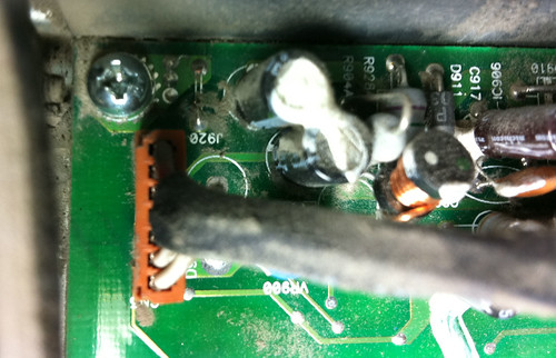

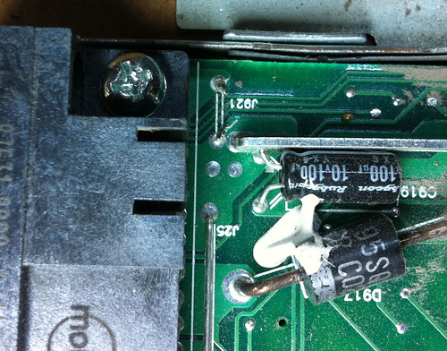

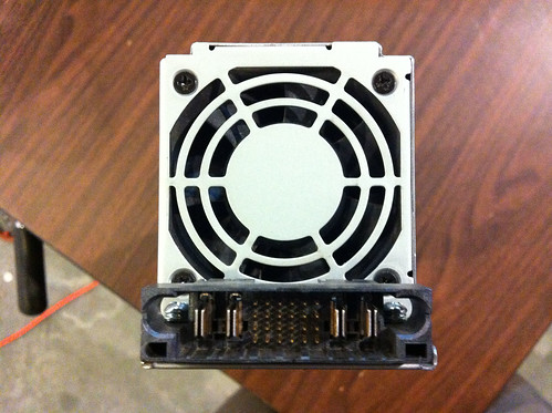

Here are some photos of the Dell DPS-500-CB chargers I'm using. 12V 41A.
I connected the pins in a pattern like this:
N N N N N N
N N N N Y N
N N N Y N N
N N Y N N N
I isolated the -12V from chassis ground by cutting two jumpers, J920 and J921 on the upper & lower halves of the case, near the output end.

Anyone ever see one of these before?
I just got a big lot of DPS-600PB's and there was a DPS-500FB in there. It's a 600W model with 2 more amps on the 12.15V line. Otherwise looks identical.
