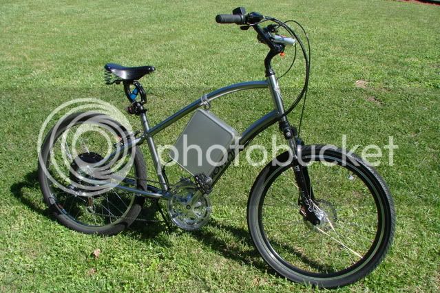

Wow, I really like that, j-vtol! It looks factory made, and great detail.
I'm going to try mounting my controller either to the outside of the box like you did, or from the inside through a hole so just the fins stick out, then seal the edge of the hole to controller with silicone for weather and theft proofing.
How about some details on how you built it?
Thanks Vim.
Well, basically I just cut the ABS plastic sheets (from local Tap Plastics store) to fit around the battery. The paneling was simply joined with Weld-On #16 solvent cement. It's a pretty strong bond, but who knows how long it will last. :twisted: The side door is hinged and closed with velcro.
Like the other cool housings here in the forum, I wanted to conform the box with the bike frame such as the back end of my current box. I also took advantage of the water bottle cage hard points for mounting. I didn't spend any time on the controller.....maybe later.
Also, use cardboard for a mockup. Once your happy, replace that cardboard with a material of your choice. Looking forward to seeing yours and others.
j-vtol

j-vtol, thanks for those extra pics of your container. I like how you also attached it to the seatpost tube. That thing isn't going anywhere! The more I look at it, the more I like it. What kind of battery is that? Your whole bike looks really sharp. I'd prefer pedals, but still.. very nice build.
j-vtol said:
Vim, your frame kinda reminds me of an old unpainted aluminum warbird or racecar. 8) That would be sick if your box was contoured.
How would you personally go about making a contoured container? I'm open to ideas. I can see the WWII fighter comparison in these frames too, and I love theme bikes. There seems to be a lack of artistic touch to ebike builds compared to the gas bicycles. I'll have to try and step it up in that direction.
I'm posting this stuff a bit prematurely as it has my usual "bever chewed" look but I have had to work with fiberglass and epoxy to make my seat fit my "big butt" so I guess once I work it all out I'll fiberglass the wood Fatpack holders and gelcoat the seat. Prolly get them finished by my local boat guru who can spray everything after I sand for a week.
The battery I use right now is a 36V LiFePO4. This is all new to me so I wanted to make sure the components (from Hi Powered Cycles .com) were pre-wired for plug and play because I have trouble with electronics beyond a TV remote.
