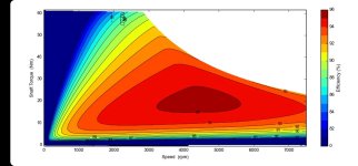

Power ratings seems rather random to me, I wouldn't put to much faith in that.
It says 59Nm peak, I think qs rates the 138 70h 50Nm, ( I just looked at cnqsmotors, it said 45-55Nm) and the 138 90h 72Nm.
I suppose this would then be a little more powerful than the qs138 70h, a little less than qs138 90h.
But there is probably more to the story, like copper fill I guess.

I am not sure about this detail because they are different RPM rate , and power. This motor is 8000 with flux . but QS 138 90H 6500 with flux.
QS write power peak 13.5kw , this motor 18kw peak. so maybe it mean QS have higher torque , but lower Power.
Torque and Power are different range.
They are different factory and machine to test also different detail cannot easy compare both.
What makes one or the other 6500 or 8000rpm with or without FW?
That depends on a lot of things, what voltage? How much FW?
I have got over 8000rpm out of a qs 138 70h at under 90v with FW.
There is a rated rpm of 3850 in the spc, and a rated voltage of 72.
I suppose that means a kv of 53,5, (3850/72) where the qs 138 70h has been tested to about 60kv.
So if that is correct you should get higher rpm with the qs at a given voltage, but they rate 3800rpm and 72v, so that suggests slightly lower :? (Maybe that is not the correct way to calculate?)

Peak torque 80Nm for 15kg motor is 0.53Nm/kg
Peak torque 55Nm for 10kg QS 138 70h is 0.55Nm/kg - so these two motors are quite comparable in the peak ratings. Peak rpm 8000 Shinwin, 7500 QS (at least that’s what qs had in their specs way back when the 138 70h motor was new)
What’s the diameter of the rotor of the Shinwin motor?
102mm
