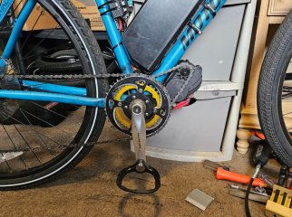

I was bending these power pins on the lightest bike mid drive unit again so that they had tension against the connector wire, and the positive pin snapped, and can't easily be replaced. So now that motor is due to be modified for an external controller.
In the meantime, i think the weather will improve soon and i just need a motor. I spent all weekend trying to find a spoked up cheap ~500w geared hub and found that the USA market keeps getting more sparse. Can't find a 700c wheel geared motor that takes a disc brake in all of ebay either. Super frustrating.

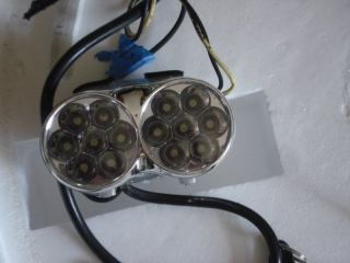

Even includes a light with some LEDs that look like a CREE type ( very powerful )

I have that light too! It came with my turn signal kit. I like it! The light is pretty wide. I've been thinking about moving my light to the handlebars to get a bit more distance and less front tire shadow.
Mine also has a horn. Maybe yours does?
No horn, so jealous!
The light, it's meant to be mounted on a suspension fork's crown, no? I was thinking also the handlebar would be a better place so that cars know i am behind them at night.

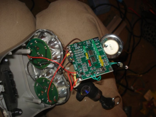

The "horn" on my Fusin kits' display/light module was...laughable. It was a piezo buzzer that would've been outshouted by the roadrunner with it's head wrapped in three feet of cotton. :lol: I don't think anyone other than the rider could've heard it, and not even that in traffic or with any wind noise. :roll:

Honestly it's a temporary kit while i build up the nerve to drill into my lightest bike mid drive, not worth improving!
Yes. I mounted my light on the crown. I’m sure I can get creative and mount it to the handlebars.
The horn is kind of dinky. It’s probably in the light, but not wired up. I got a horn like this one…
…and wired it in instead of the dinky horn. This horn is amazingly loud for its size and gets attention. I haven’t reinstalled this since moving to cycle analyst/baserunner, but I’d really like to install this in my frame and hide it. I feel it’ll be loud enough even inside the frame.

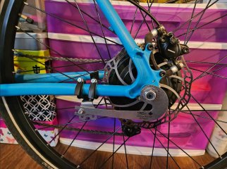

Ditched the old torque arm for a new 12mm grin unit so that i can have easier innertube changes and much less torture on the dropouts w/this small 12mm axle.

DIY rear brake caliper mount spacers?
Yep, to counter the axle offset -> disc spacing problem inherent with this kind of axle.
With a proper 180mm adapter, i was only getting half of the brake pad to contact.
