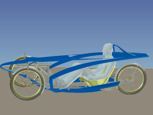

First idea of the bodywork.
This is not going to be it, I am just getting my mind around the various parts that I would like to have covered.
Maybe I will go the other way and only do the sidepods and maybe a simple cover over the top and nothing else.
Afaik in a velomobile the rear of the fairing is very important for low drag figures. They even sell a short and a long faired velomobiel, with the comment that the long one is much faster...
Currently I am not that interested in low drag or perfect aerodynamics.
It is all about the steering and tilting mechanism for me.
The only reason I am thinking of bodywork is to protect my legs from stones as there are a lot of loose stones and such on the roads here.
This is what I call the ribbon body. Bodywork reduced to the minimum. I like it, but I am not done yet. It is clear that aerodynamically this is not a good solution, ah well.

I have been working on some things tho. The chassis is designed and strong enough. I have modified it a little and have space for 2 battery packs, if I want to go there.
Really can't wrap my head around the bodywork, I just can't seem to get a shape that works for me. Ah well, maybe when I have the bare steel there, it will form itself.
