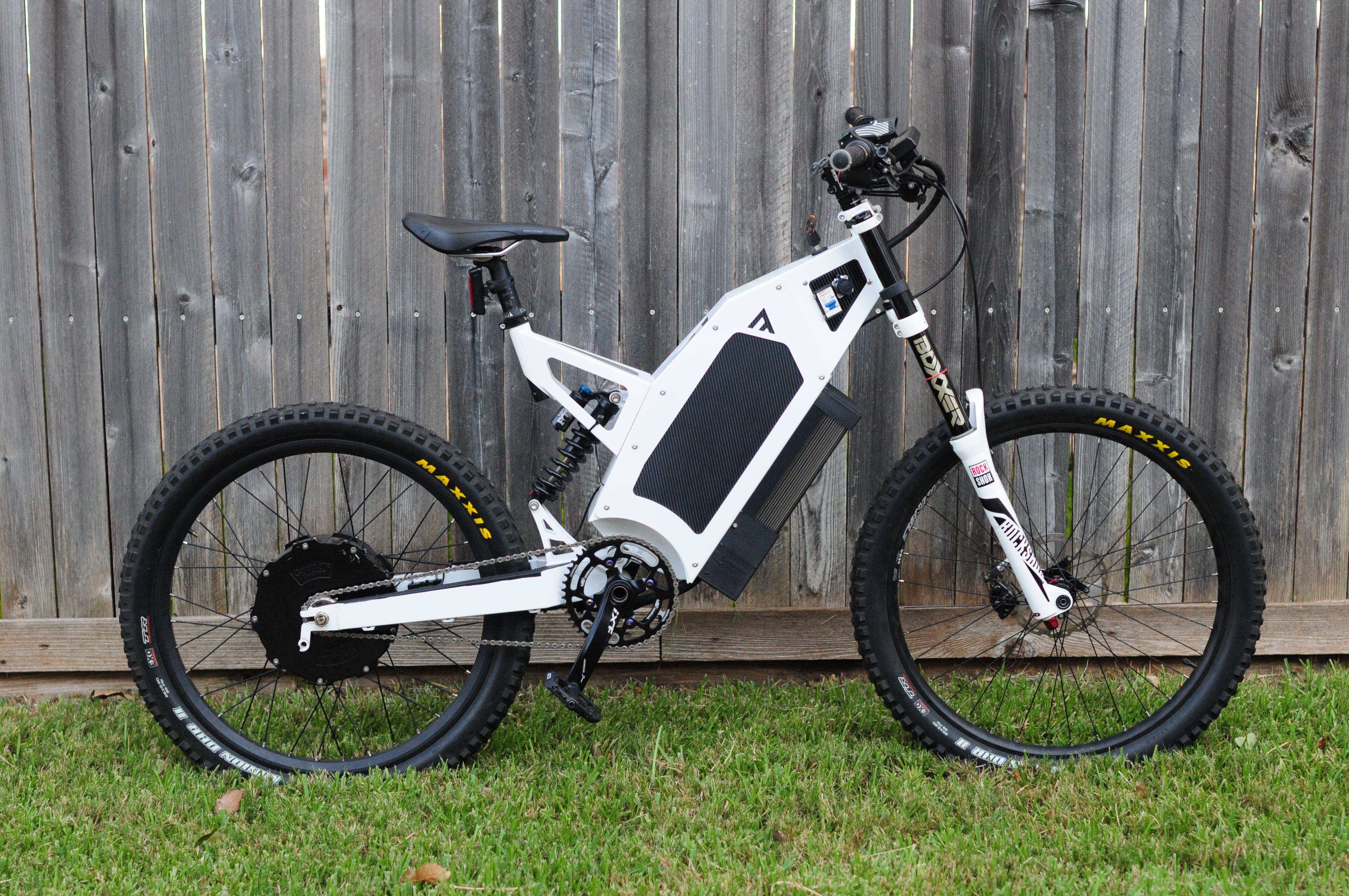

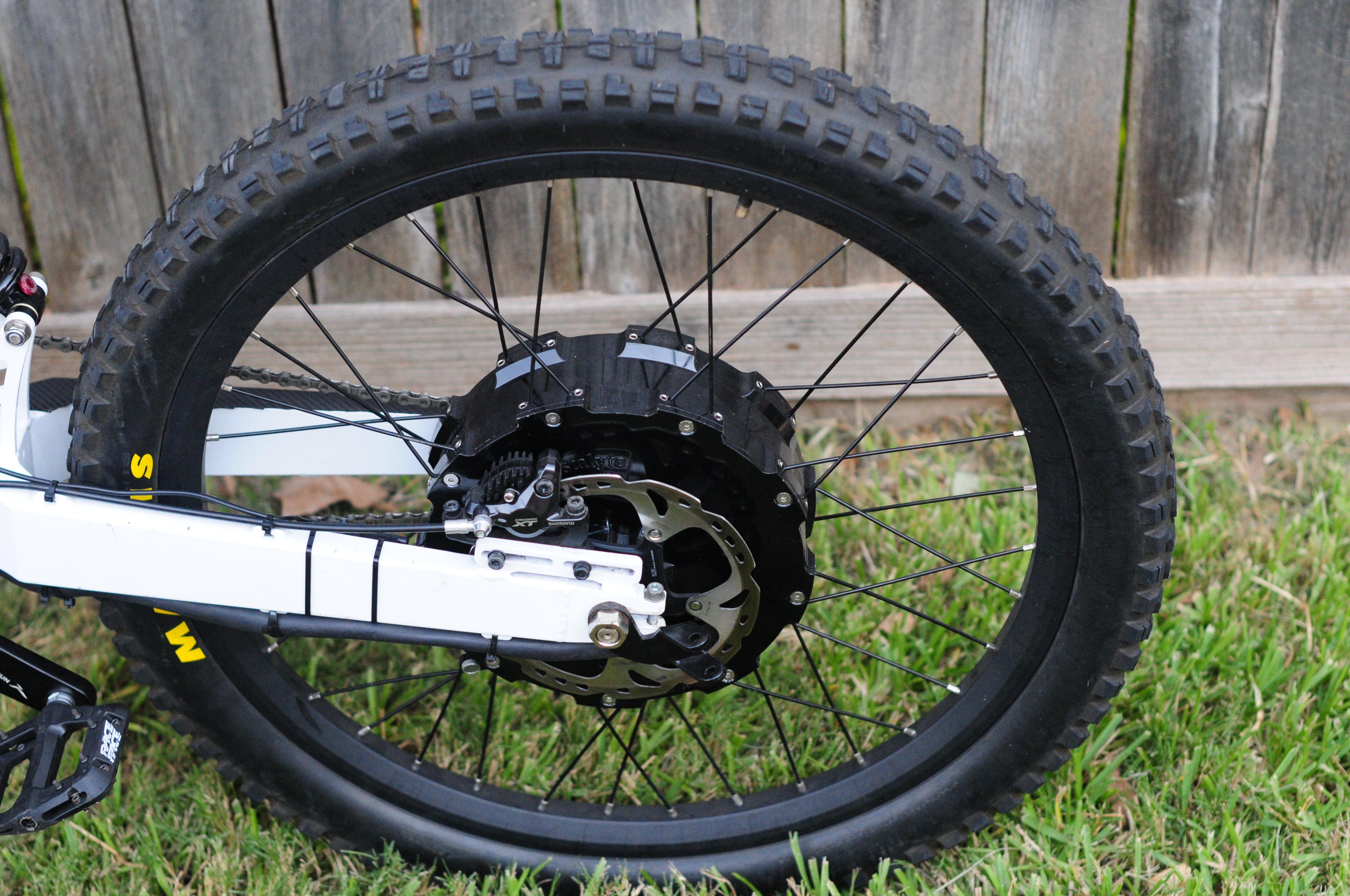

Final pick of the bike at 95% completion.
All that needs to be done is tidying up the wires on the inside of the frame (Couldn’t wait any longer).
Couldn’t be happier with this 7 month work in progress. Everything just feels solid. in the next couple months, may swap out the Chinese suspension for name brand, American designed, components
Performance wise, the x5403 With 18fet SW controller absolutely (and silently) hauls ass straight up to 40mph before I chicken out to go any faster.
Poking around for a lighter motor to use when I don’t need “v8” power output all day long. Anyone have leads on these new H50/55 series motors?
Only thing I don’t like is the brakes. I got mt5’s up front and feel as though I didn’t bed them properly as they feel a little “soggy”, until they warm up with a couple solid braking cycles.

Weird about the MT5, I have them on 2 of my bikes, they stop really well. You may want to bleed the brake and spring for some new pads. When you said they feel soggy until warm tells me the pads may have been minutely exposed to oil, such as the mineral oil in the system.
look into sintered pads, I have found them miles better on my hope brakes, I also have ran uberbikes pads and found them to be preety good also (not sure they are better than sintered, probably equal, but for the hope brakes they have cooling fins on the pads which help with fading) :thumb:
