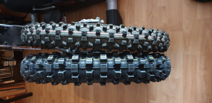

iam running tubliss now and iam very very happy with it.
as advertised saving weight it maybe true for normal enduro/cross bikes.
for our lightweight setup it adds 500g on top. (normal moto tubes are 300-350g...tubliss 18" has 800g)
some guy posted here about wobbling not stable rides with low PSI.....
i cant follow that.... i have tubliss only on the rear, but cant imagine it can be that bad on the front.
my front is 26x3.0 bicycle tire and iam running only 1.3bar/19psi
my rear is 18x3.5 moto wheel and iam running only 1.0bar/14psi on street and 0,3bar/5psi offroad.
this gives you grip you dont believe if you dont tried by yourself
it climbs like a goat on every terrain.
fluffy and plush like cotten candy over roots and bumps
switching from 19x1.4 - 2.75 Shinko SR241 (5.1Kg rear Wheel)
to 18x1.85 - 3.50 CST 755 (7.0Kg rear Wheel)
so it adds 1.9Kg to the rear. 205 Hub Guys would laugh about. i do either. i notice it only lifting the bike around.
while riding no difference to me in weight. even i would notice it, i wouldnt care because of the fluffy monster grippy ride now.
Pics with weights below. Have no Pic of the Shinko 2.75/19 but it was 2.8Kg.
the CST is easy to put on the rim. its not so hard as other tires.
including rock solid Excel Rim, Tire and tubliss system i think its a very good upgrade for me =)
full bike weight is now 46,5Kg fully charged
