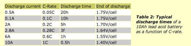

I've been posting sproadically, but came up with a design question for my bike.
I'm intending on running a BMC puma motor on the rear wheel with two of the EV-tech 37v battery packs. I've designed a 3 switch setup that can allow the running of either each pack individually, in series, or in parallel. Will this kill the controller? the batteries? or the motor?
My theory is to use 37v all day every day, unless i need a large speed boost, and then to use the ~74v mode
If u look at the picture below it could be setup that indicate something like this:
X Y Z Mode
0 0 0 Off
0 0 1 Batt 2 only
0 1 0 Series
0 1 1 ERROR
1 0 0 Batt 1 only
1 0 1 Parallel
1 1 0 ERROR
1 1 1 ERROR
now this could be setup with some simple logic to a 6 position rotary switch controlling relays.
Has anyone tried anything like this?
Is this bad for any component?
Is it not possible for some reason (I am a newbie in electrical engineering (but not digital logic) )
Got any general observations?
If this 2 way battery setup is possible, then i'm hoping it may be possible with a microprocessor to control 4, 8 or even 16 way setups.
