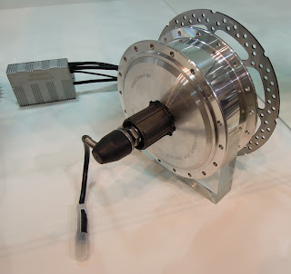

Dapu motor links (Japanese?)
http://www.topsecretev.com/blog.php?categories=Taipei Cycle show 2012 highlights
So that is the same as this one on the Neo Jumper, and they actually say it can be over clocked. So the 48V battery while the motor could handle it albeit at loss of longevity, the electronics would be the challenge?
http://www.electricbike.com/easy-motion-jumper

We've established that the speed measurement comes from the white wire in the multi-pin motor connector. I haven't got one, so can't measure it. It'll use a hall sensor to pulse on and off. You can check it easily with a meter to count the pulses per revolution by probing it with a meter whilst connected by turning the wheel backwards slowly. If it has it's own hall sensor, there will be one pulse, but if it shares a timing sensor, there will be several. Probe between white and black (ground) wires.
There's several ways to fool the system to make it think you're going slower.
1. You can use a microprocessor or any other electronics to reprocess the pulsing to a lower speed.
2 You can put a magnet on the back of the pedal and use a cycle computer sensor or hall sensor connected to the 5v throttle wire to get a pulse at pedal speed, which will be slower. This method used to work on the Bosch motor until they changed the software.
3 Assuming that it gets the pulsing from a timing sensor, use a normal cycle computer sensor and magnet on the back wheel.
Someone needs to test these methods. I can only be theoretical because I don't have a Neo, but it's a 5 minute job to try the latter two methods.
It would be nice if someone could check the number of pulses per rotation.
