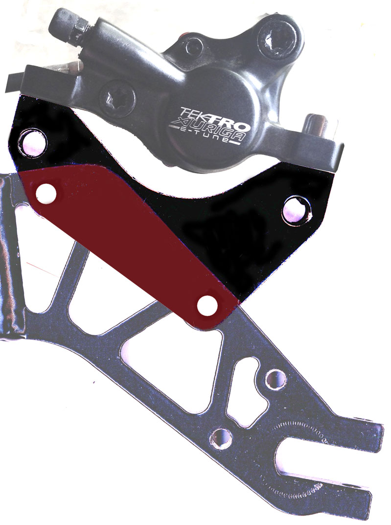

does somebody make a shifted caliper adapter?
I don't know of anything like that. On a steel frame I'd just fab/weld on my own 203mm caliper mount bracket onto the frame, taking from post to side mount. It could be pretty simple like nuts and scrap metal.

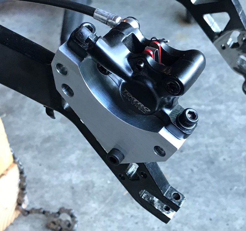

I just machine 2mm off the caliper mount to move it outward a touch.
This is a 50 tooth 219 with a 203mm rotor. The Caliper fit by hanging over the chain between the rotor and the wheel. Depending on the brake pads the little tabs on the pad need to be shortened slightly. It was that close and 50 teeth is all you are getting away with.

I'm making offset caliper mounts right now. The caliper previously sat on top of a bracket bolted inside of the dropout. With the new position of the rotor the caliper needs to sit right on top of the dropout. The new mount bolts on from the outside and has a relief milled into it for the dropout.

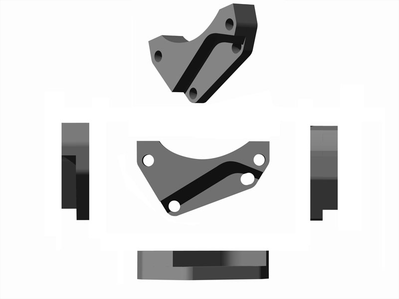

The first batch of five offset caliper mounts are back from the machinist. The mount positions the caliper mount screws right over the swingarm where they need to be for proper rotor alignment. I couldn't trim the existing bracket. There would have been almost nothing left of it.

Yep. The new caliper mount will be part of the swing arm drive.
