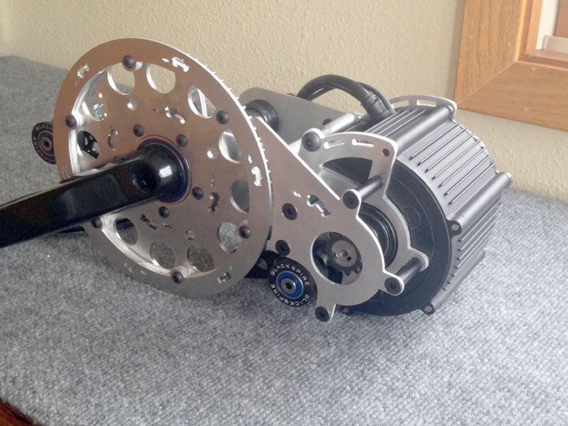

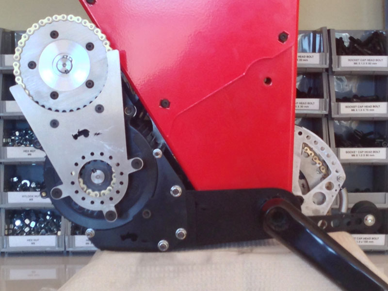

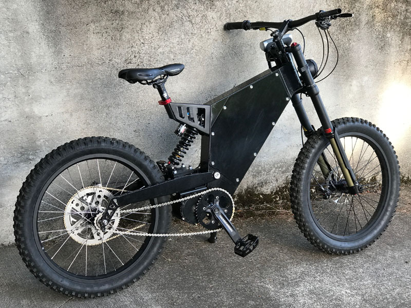

Thanks for all of the feedback. I currently build three drives that will fit the Qulbix frames.
#1- Two stage bottom bracket drive.
Mounts to: Bottom bracket and front of battery box.
Motor reduction in drive unit: From 40:1 to 8:1
Freewheels: Two. One in primary driven sprocket for pedaling, one in BB for motoring without pedaling. (The sample drive in the photo has an optional billet freewheel delete hub in the sprocket)
Regen: No
Can pedal with motor: Yes, at reductions of 30:1 or greater.
Motor runs through bike gears: Yes
#2- One stage bottom bracket drive.
Motor reduction in drive unit: 6:1. Final drive ratio ranges from 11.5:1 to 3:1.
Freewheels: One. One in BB for motoring without pedaling.
Regen: No
Can pedal with motor: No.
Motor runs through bike gears: Yes, or two stage single speed with a single rear sprocket on right.
#3- Swingarm drive.
Mounts to: Swingarm
Motor reduction in drive unit: None. 8:1 reduction to rear wheel is standard.
Freewheels: None
Regen: Yes
Can pedal with motor: Yes, up to the limit of the pedal gearing.
Motor runs through bike gears: No. Single speed on left side.
There are advantages and disadvantages to each one. The two stage drive is best for steep climbing, pedaling with the motor, extending battery range. The one stage is best for going fast, moderate climbing, running over 3000 watts through the bike gears. The swingarm drive is meant to be as simple as possible. Many people avoid mid drives just because of the number of moving parts. The swing arm drive is an alternative to hub motors that is lighter, has reduction gearing, and is positioned close to the fulcrum point of the swing arm.

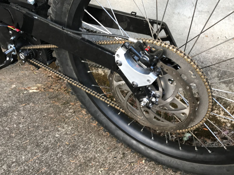

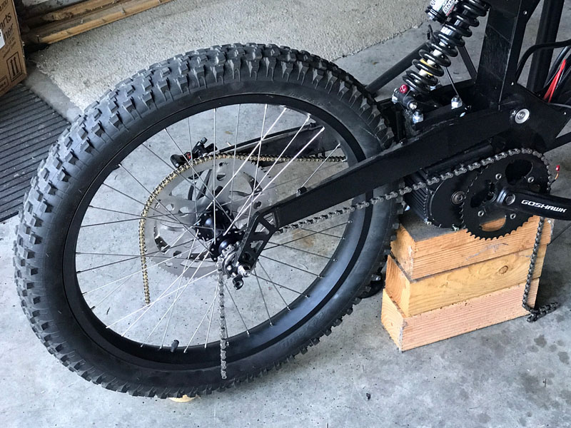

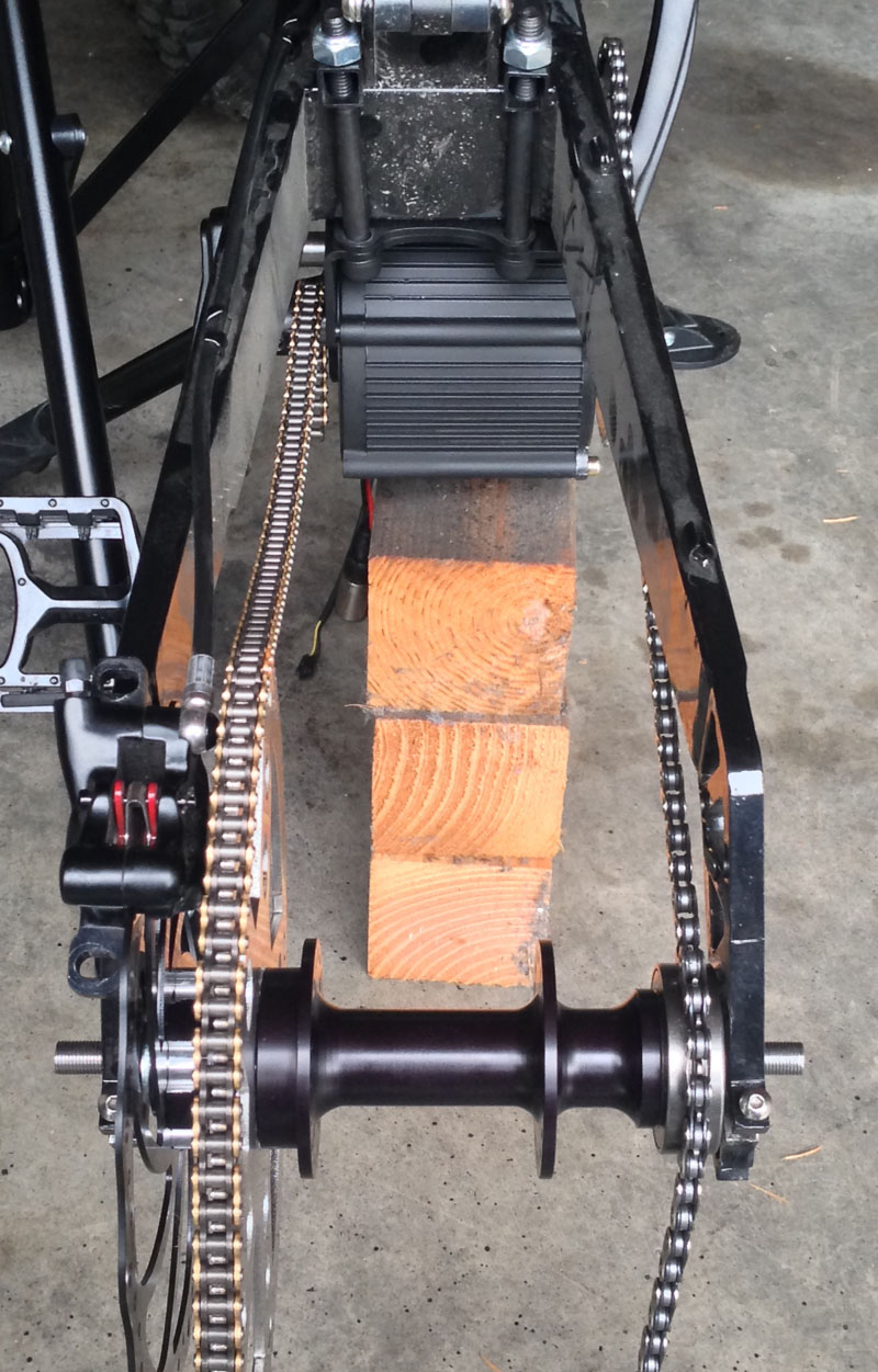

I'm working on the details of tensioning the 219 final drive chain on the swingarm drive. I have a handy calculator which tells me the number of chain links needed for a given sprocket set and center to center distance. Using this calculator I determined that one link pair of 219 chain changes the center to center distance on my particular sprockets by .313". I mapped this out on the Qulbix swingarm dropout slot:
So we have wiggle room of +/- two link pairs. The center of the slot's travel is ideal. That's 162 links.
I've ordered these chain tugs to help keep the axle from moving forward under power:
Laid over the 10mm axle and dropout slot they look like this:
The raised bar on the tug that goes into the slot will either fit perfectly or need just a bit of massaging on the front edge. I just ordered them this morning so I'll have to wait until they arrive to know for sure. They were only $18. No way I could have them custom made for that.
Thanks for the feedback on the effects of regen braking on chain tension. I was already worrying about it. The comments helped me stop worrying and start dealing. This setup will be much better for the two way loads of a solid mounted sprocket.

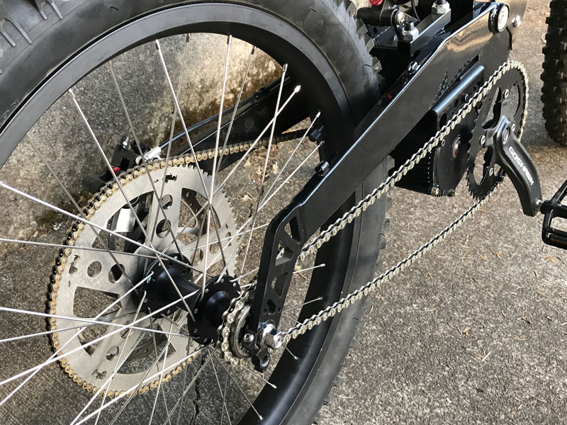

Getting very close to done. Just little details now and she'll be ready to ride. Chain tugs for the 219 side and a derailleur style chain tensioner for the pedal side. After that it's mostly wiring.
That thing is going to be insanely fun! Hubmotor power levels with bike level unsprung weight is a win win. Its made even better because you don't give up regen. Watt for watt I think Single speed direct chain drive is the best high power solution for ebikes.
Glad you addressed the regen axle issues. I was shocked by how easily the regen forces were able to slide my axle. Powered LH motor chain tension kept that side from sliding rearward but the right side took all of the force and made the wheel all crooked. I guess using rim or disk brakes there is always an anchor to the frame that is somewhat holding the wheel in place. With chain regen the interactions of the forces are just harder to visualize than what we are used to. It's almost like the tension on the bottom run of the chain tries to drive the wheel backwards out from under the bike. I need to draw it all out visually to totally understand it but I can tell you for sure that it needs to be dealt with.
Those $18 tensioners are the same ones I use. They work but will likely need to be trimmed in the front. That raised up block portion is in the way for me. Wish they were just disks like an axle washer.
Did yo buy your front 219 sprockets from a regular retail site or do you have a supplier? One of mine is total junk with way too much runout between the bore and sprocket. I'm wondering where to get others someone can vouch for.
There have been a lot of hub motor Qulbix built. It's good to have some mid drive options available. When you look at how much time and money motorcycle and car manufacturers spend in trying to eliminate grams of unsprung weight from their vehicles there has to be a reason. On a dirt bike you not only get a better ride and fewer trashed rims, you have a wheel that will follow the terrain better and put more power down.
The PowerVelocity sine wave controller that I'll be using on this bike has variable regen, programmable via Bluetooth from an iPhone or Android phone. Because of how insanely hilly my neighborhood is I'm more interested in the braking effect of regen than it's battery charging.
This drive is about as stripped down and simple as it can be. As long as the chains are well managed and run without issue there is not much to go wrong. I can't go any larger on the wheel sprocket because of swingarm clearance. I could run an 11t motor sprocket if I could find one that would fit. The line of sprockets that I had made in Taiwan stop at 12t. Most 11t sprockets are specific to Rotax or Yamaha kart motors and have tapered bores and other funky stuff going on. It would be nice to have the option of 9:1 gearing in addition to the current 8:1.
This thing is going to be a beast. Looks like similar reduction to what im using. But im sure your bike is alot heavier so dont be scared to feed it the power!
Efficiency goes down and noise goes up when you get too small on the front. I think 12-13 is about the smallest you really want to go anyway. The common motor options available are just a few kv too high to cover the whole useful range in just one reduction stage. Adding a 2nd stage is an even worse hit on efficiency. Seems like there is always a compromise.
The kart racing sprockets with the big flat 3 bolt flanges might be a good option for quick changes out in the field. You could sell an adapter that mounts to your motor shaft with 3 tapped holes to mount these.

I think the chain tugs are the best solution, Luk. I've built your Big Block motor and started work on your swingarm drive. I'll let everyone know how the chain tugs work once they arrive. They've shipped.
Looking around the internet I've found 11, 10 and even 9 tooth 219 sprockets for racing karts. I understand that they are noisy and will probably not last as long as a 12+ tooth sprocket. It would still be nice to have the option of lower gearing.
I like belt drives a lot. There are a few drawbacks with them:
They're much wider than chain drives.
They have to be more carefully tensioned than chain drives.
They have to be more precisely aligned than chain drives.
You have to be able to find a pre-made belt in the pitch, width and length you need.
In this application we'd need a wide belt with a fairly large tooth pitch to handle the power. There is barely enough room to squeak a chain drive in. The Gates Carbon Drive belts are only available in a few standard lengths. I'm also not sure that bicycle rated belt will handle this much power. On a bicycle the final drive is usually between 2:1 and 4:1 overdrive. The large pulley doesn't have to be that large. We're trying to get 8:1 reduction. With a coarse pitch on the pulley it would have to be very large to provide 8:1.
I think it has to be chain drive in this application.
