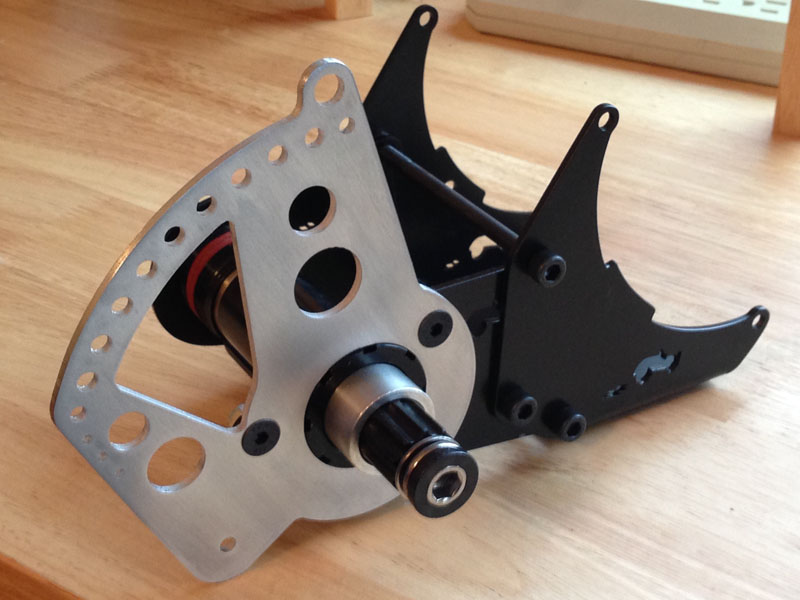

tikivic said:Quick update.....made a chain guard.
John Bozi said:tikivic said:Quick update.....made a chain guard.

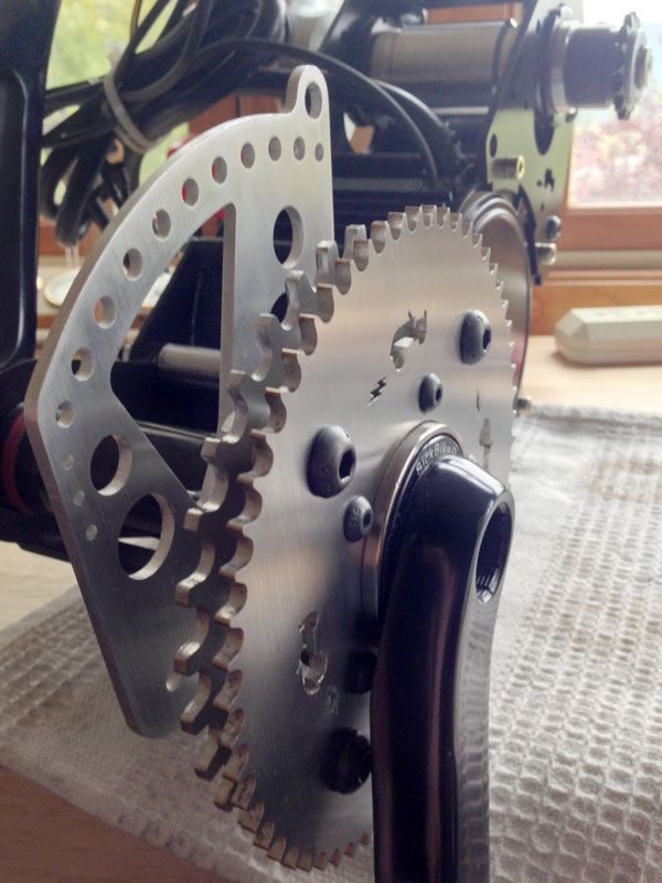

If the crank speed is too fast to pedal anyway could you embrace that concept and eliminate the jack shaft and it's brackets. Then just turn the motor around in its bracket (so the shaft is on the same side as the chain rings) and put on one of your chain drive conversion sprockets with no freewheel on the motor. Then run the small sprocket on the motor to a large sprocket on the crank freewheel. Then have a sprocket as small as possible on the inside of the crank freewheel running to a big single speed sprocket on the wheel freewheel. I think the last stage should also be #219. This gives you a bike whose pedals technically work but have a very very low top speed and the drag of the motor cogging if you pedal with out it. On the upside the parts count of the system is the irreducible minimum. I have been thinking about trying this for a while now. Will the motor fit in the mounting bracket the other direction? I think this set up would also be narrower because you get rid of the primary side drive.LightningRods said:The chainwheel drive Qulbix mid drive is coming together. I assembled the new chainwheel parts today. 60 tooth 10 gauge stainless #219 driven sprocket, 34 tooth 11 gauge stainless 1/2" chainwheel, White Industries UHD freewheel, M8 class 10.9 hardened bolts for chainring bolts. In addition to all of this motorcycle grade hardware this drive also has 1/3 the reduction of my typical street/trail mid drive. You can't pedal with the motor- the chainwheel is spinning at over 300 rpm. However torque stress is reduced by 2/3 and you can now use the high tooth count sprockets on the rear hub and still have good speed.
The upper bracket bolts directly to the Qulbix battery box. It's not twisting or flexing no matter the power level. The lower bracket is now supported by 1/2" round aluminum standoffs and full width M6 10.9 bolts. There will be a spring loaded DH guide wheel/tensioner attached to the bottom rear of the aluminum guide plate and a urethane lined fence guide on the top.
Yes single speed is what I was envisioning. A 12 tooth on the motor and a 72 on the crank gives you a 6:1. Then maybe the smallest you could put on the inside of the crank is a 40 tooth (#219 sprocket) going to another 72 on the rear wheel 1.8:1. 6*1.8=10.8:1.LightningRods said:If you did what you propose reduction would be about 6:1 or 1/2 what it is now. Chainwheel rpm would be about 500. This could work fine for a single speed. Low speed sprockets would start to get too huge to shift with a derailleur.
The motor will rotate 180 in the motor bracket. I'm sure that what you want to do is possible. Single stage from the motor to the rear wheel is simpler.
