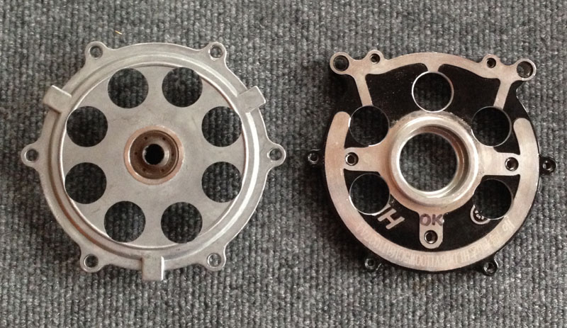

I'm having a special ported case Big Block made for Electric God. The air circulation should allow for maximum power. He's going to run it with his giant Kelly scooter controller as well as the Adaptto Midi-e and Sabvoton.

If you're running 82 volts you would only be running about 61 amps @ 5000 watts. I've run the big block at 52V 70 amps without it getting hot. Cheekybloke is running around Sheffield with a closed case big block at just over 5000 watts without overheating. It will be interesting to see what kind of peak power we get with the ported case motor. At 100 volts with a ported case it should be at a whole new level.
I had a customer running the small block at 100V 50A two years ago. I didn't promote those numbers because I had visions of melted and exploded motors coming back at me. The harder you push your equipment, the shorter it's lifespan. That's true of internal combustion, it's true of electric motors.

ElectricGod said:I know this much, when my temp meter reads 150F and I touch the motor, it's uncomfortably hot...like 150F should be. I can always put a second temp meter on the outside of the motor case and see what that reads. My existing temp sensor is inside the windings where it is likely to read the most accurate motor temperature. I'm just saying something is hinky and I don't know what it is...me or other peoples reports of motor wattage.

LightningRods said:I have the ported Big Block motor cases back from the machine shop. They turned out great. The output side still has a lot of meat left in the cover so it should be strong enough for mounting and power transmission. These ported cases combined with a shaft driven cooling fan should provide a nice power bump.
