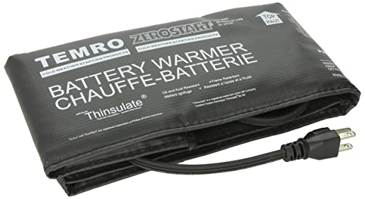

On another note, when I have built my battery, I didn't know what case to put my cells into. It was summer, and most of the members like dogman were fighting hot temps, and suggested to use aluminium casing with good venting to protect the battery. Now in winter we want best isolation and possibly active heating
I ended up with a 4mm PVC casing completely closed and sealed with silicon in the summer. Still performs well in -5C temps. I rarely use my bike in colder weather.
