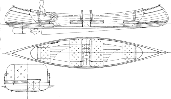

The canoe I'm planning to build is the Selway Fisher Raven on this site: http://www.selway-fisher.com/Opcan16.htm. It's a ply, stitch-and-glue, open canoe. It seems to need around 40 watts or so to travel at 3.5 to 4 kts. It's maximum hull speed is about 5 kts, but it would need around 200 watts to reach it. My plan is to build a cruising boat that I can use to travel inland waterways and lakes at normal paddling speed, hopefully with some solar cells to augment range and allow charging when not moving.
The finished canoe should look like a scaled-down version of a typical Victorian electric river canoe like this one:
Make the hull in the clip longer and it's likely to go faster on the same 200W. I'm looking at building a 1000-1500lb cat that can handle another 1000-1500lb of passengers, and is sturdy enough to be comfortable 30-40miles out in the ocean, and will achieve 6-7 knots (the high end of trolling speeds for sailfish, marlin, tuna, and mahi, which a prevalent here "in season") using only 1200-1500W.

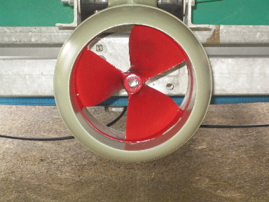

Nice site here (in German... ya can use Google Translate for English if ya like) showing more work with kort nozzels on a small eboat:
http://www.sinusleistungssteller.de/Brummer.html
...which leads to:
http://www.e-jet.org/
Their largest design (they are not in production yet):
E-JET-170L-8000:
Input voltage 24 to 48V
Input power up to 8KW
Thrust / bollard pull up 120kgf
Diameter 230mm
Rotor diameter 170mm
Length 170mm
9kg - Weight 9kg
