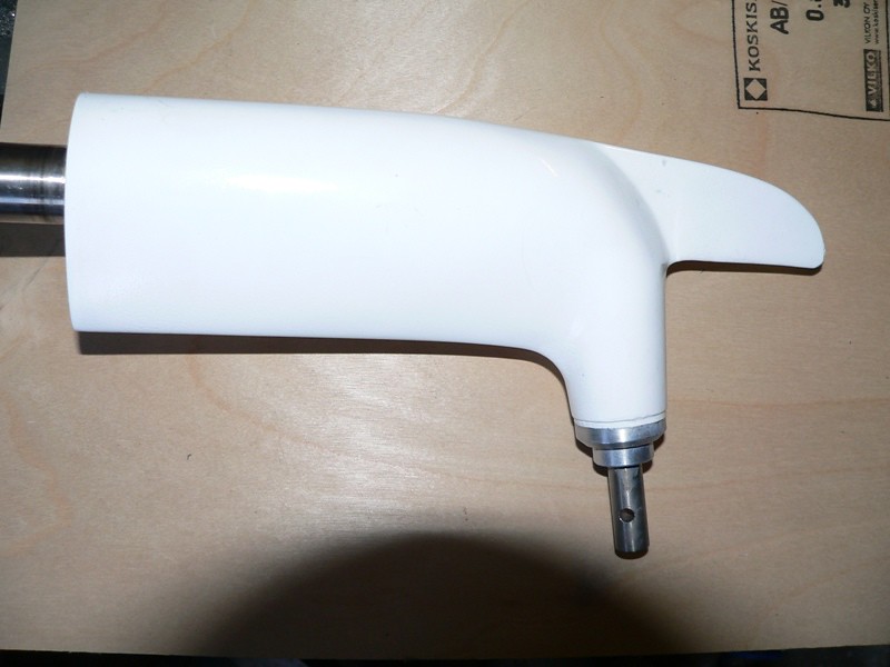

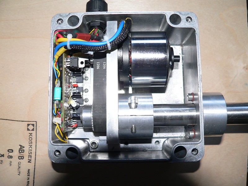

Time for a long-overdue update. Apart from playing about with ways to get a more efficient drive unit, I've also ordered a custom built hull. I've just got the first pictures from the builder and have to say that it's looking pretty good. Here's a sneak preview of the super lightweight (4mm marine ply) hull, minus the deck and transom:
The motor drive has evolved so that I no longer need the noisy and expensive right angle drive reduction gearbox. Instead I'm using a belt reduction drive coupled to a double universal joint. This is extremely smooth and absorbs less power than the gearbox, plus it's a lot cheaper. Here's a photo of a prototype 100 degree angled drive using this method:
I made a composite housing by laying up some epoxy/glass over that alloy mandrel in the photo, then I split the moulding in two with a Dremel to get a housing that locates the two bearing housings. The output shaft housing includes a seal and the input shaft will be bonded into the drive leg. When finished, the whole sealed lower leg will be filled with light oil. I've opted to use a slightly bigger angle for the final version, of 120 degrees, because it fits the transom profile of the boat better when lifted up (the motor shaft fits through a centreboard-like case in the stern compartment of the boat, so will be invisible normally from outside the boat).
The next job is to make a fairing to go around the leg, so that it's nice a low drag. Total power losses at maximum speed on the prototype motor, controller, belt drive, bearings, seals and universal joint are 12 watts. At cruise power the losses should be around 8 watts. This means I'm probably on track for my target of no more than 100 watts to cruise at 4 mph, making solar power augmented cruising viable.

That center section of the driveline will have continous rotational speed changes twice every rotation based on the amount of angularity at each joint. Running the second joint 180 out of phase counters the shaft deltaV for the remainder of the shaft/prop, but the section between the two will be a continous source of some of that 12w inefficiency, and getting as light as possible on that mid-shaft section reduces this loss. At your low speed range though, it may be trivial.
You're right, Luke, the short centre section between the two UJs does have a fair variation in rotational velocity with each rev. You can just feel this as a sort of very slight pulsing if you hold the casing whilst it's spinning. I haven't measured the UJ losses alone, but the lower unit losses, which includes the bearings and the shaft seal are 5 watts at maximum rpm and around 3 watts at cruise rpm. Most of the loss comes from the shaft seal, which I know soaks up around 2 to 3 watts at full speed. From this I would guess that the UJ and bearings absorb around 2 to 3 watts, which is tiny enough not to worry about.
So a double U-joint results in constant velocity of the output shaft? I've gotta do a shaft drive now. I don't think I showed you the big brushed motor I have. It's too long to reasonably mount with the drive shaft parallel to the wheel axle, so that's been on hold pending a good right angle gearbox solution.
That's right, John, using a double joint like this does give you a CV joint. The joints are pretty nicely made, too and run very smoothly. The one I'm using was made by a company called Lenze (http://www.techdrives.co.uk/html/universal_joints.html) and cost around £30 (~$45). My power and torque requirements are modest, so the joint I'm using is only 22mm in diameter, but they make much bigger ones, capable of handling pretty high torque levels and higher rotational speeds.
Jeremy
Jeremy : great job.
Your engineering concept of that "double u-joint" encased in the composite housing is interesting.
Just my opinion, from practical decades of u-jointed power-shaft boat usage: It may have some "wear" problems if that is the end to be submerged.
Traditionally, propulsion units that use a U-joint to shift direction get a bit of "wobble" on the joint. Your light oil filling of the inner housing can leak out pretty quick.
This was the case of "J" tubed cable-shafted electric boat motors from before WW1. The heat and cooling causes expansion & contraction, and if the lower seal is left in the water, well the seal often leaked.
May I suggest you use screw-on caps with "O" ring seals at each end of your housing (use of Oilite bronze bearings in the center of the caps)? Put zerk fitting on the housing casing , then use marine grease instead of oil. The pressure/viscosity of the grease keeps the U-joint better lubed, and wont weep/leak out so easily.
Oh, I am curious. Since you may extend the angle to 120 degrees, why not stick the whole shaft/joint into a bent piece of pipe with appropriate inner diameter?
Thanks for those tips, I'd love to know more about the old J tubed electric drives, I'm thinking that these may have looked a bit like a bent tube strimmer drive (weed whacker in US-speak), would that be right?
I did try to get away with feeding the shafts and UJ down inside a tube, but couldn't find a way to do it. Whatever way I tried I needed to get the lower end of the UJ out the end to connect the prop drive shaft, and the geometry just didn't seem to work to allow this to happen.
I'm running at low power (around 100 watts), so I'm hoping that wear won't be a big issue. The boat won't be kept in the water, either, it's not much bigger or heavier than a canoe, so the plan is to keep it at home and trailer it to the rivers and canals nearby.
The output shaft is supported by two ball races, with a seal on the outer end. Similarly, the long input shaft is supported by a single ball race at the lower end and a pair of races at the upper end (to take the side load from the driven pulley). The UJ is therefore pretty well supported, as the UJ outer ends are butting up against the inner races of the bearings on each shaft.
The other factor that makes me hopeful that this will last, is the relatively low operating rpm. Maximum prop rpm is just over 700 rpm, cruise will be around 500 to 600 rpm.

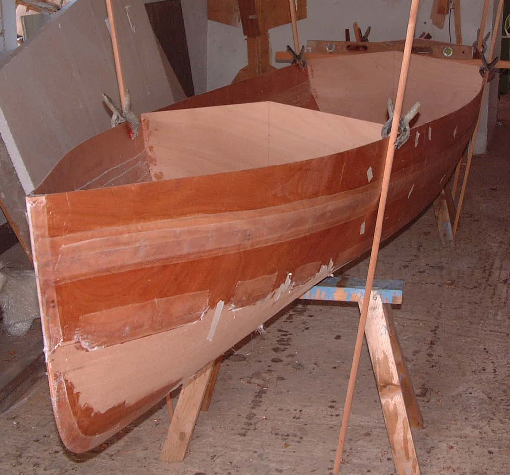

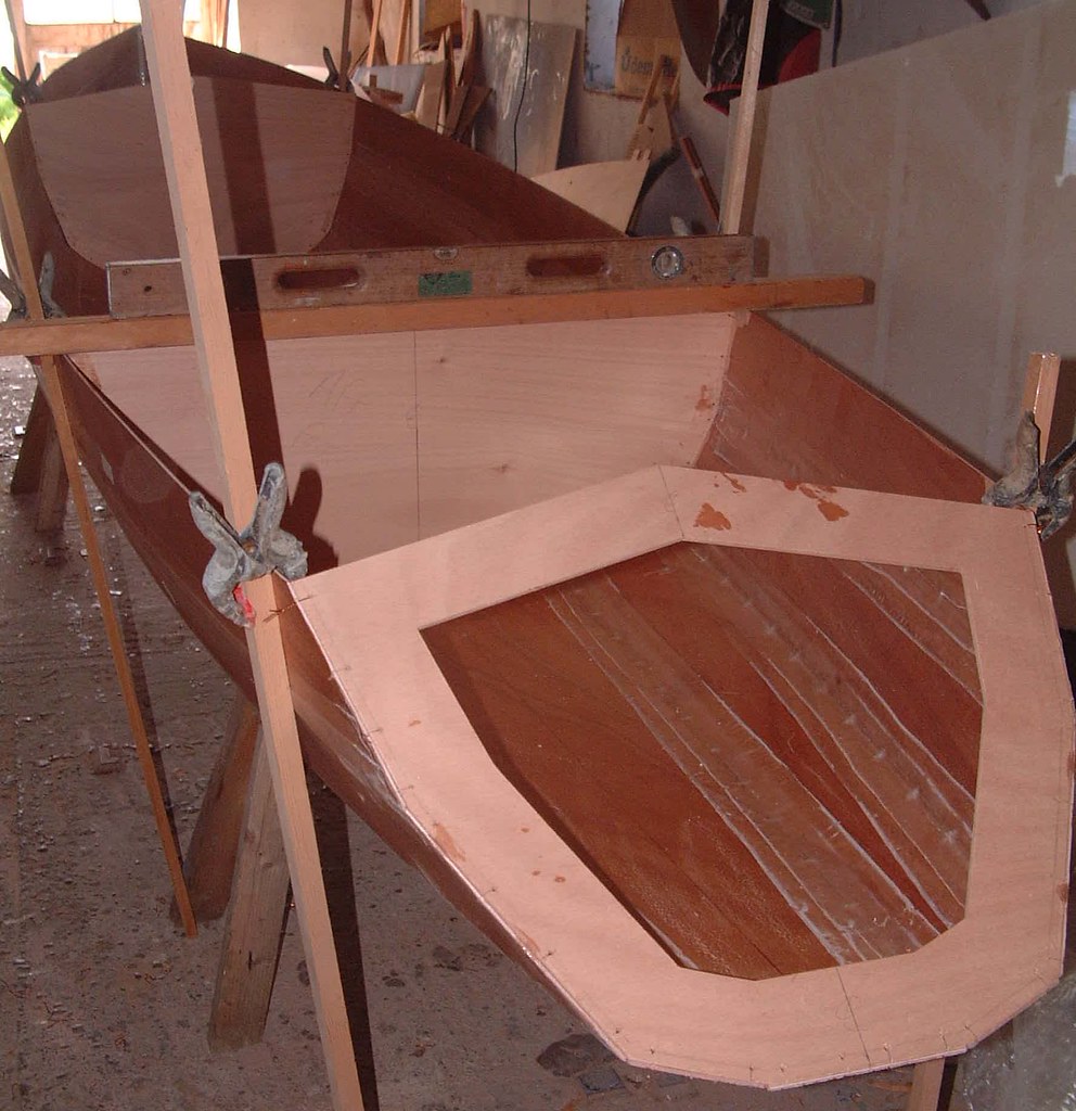

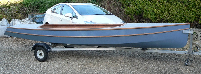

An update on this rather long drawn out project. I made a 9 hours round trip today, to the far West of Wales, to collect the hull for my project boat. Here are a few photos (although please bear in mind that the hull is only painted in primer and the woodwork hasn't been oiled yet).
The next step is to fit the propulsion system, give the boat a coat of paint, then go and do some trials on the water to see if the performance matches expectations.
Jeremy
What a beauty Jeremy! a friend of us took us with his little boat (normal gasoline powered) for a trip. For me it was the first time.
It looked so peacefull and quit on those little water creeks/canals. And when i saw your snapshots ....wow...must be very relaxing.
Are you going to use some solar storage in the future?
Many thanks for all the kind words. I don't know the weight for sure, but I can easily lift one end up with one hand. I lifted the whole hull, single handed, from the trailer on to a couple of saw horses yesterday and it was no effort. My guess is that the hull as it stands probably weighs about as much as a big canoe.
Here are a couple of the latest pictures of the drive unit. First, the power head, with the TowerPro outrunner, belt reduction drive and modified 6 FET controller:
The 1" stainless tube that contains the drive shaft goes through an O ring seal inside the machined alloy block to the right of the photo and the diecast alloy box that the whole unit is in is sealed to IP66, so I'm confident that it'll cope with working in a damp environment. This unit is actually fitted inside a watertight compartment in the stern of the boat, so it should stay pretty dry, but I've learned over the years that water gets pretty much everywhere on board a boat!
