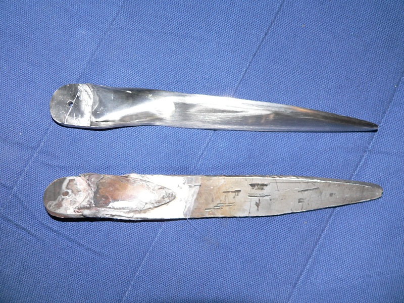

Luckily, the human powered boat people have been facing the same problem, as they only have a very modest amount of power to play with as well. A chap in Australia, Rick Willoughby, has come up with a neat way of making a folding prop. If the blades catch a bit of weed, then they fold back under the extra load and it slips off. Apparently this system works well. I've spent the last couple of days making a set of stainless steel blades. The starting point is a strip of stainless steel sheet, that is twisted to the correct pitch angles (checked with templates at four radial stations. This is then cut to a rough profile shape and has stiffening pieces silver soldered to the root section:
The grotty bottom one is a near raw blank, the top is a partially finished blade.
The blades are then hand ground to shape, using templates to get the right aerofoil section at each point. This doesn't take as long as some may think, perhaps an hour or so per blade. Much of the time is spent checking to make sure both blades are identical and follow the templates accurately.

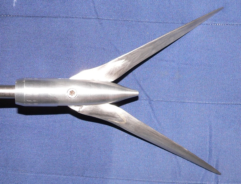

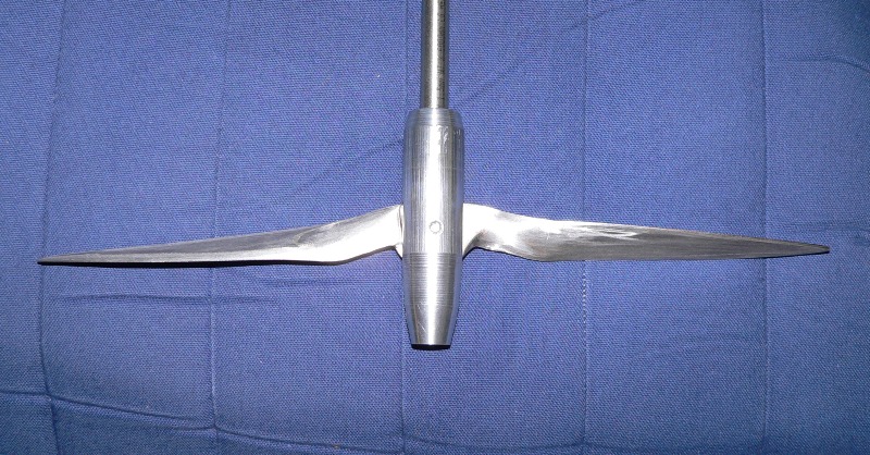

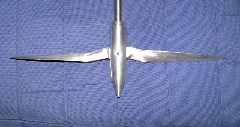

I've now finished the prop and hub. Here's a picture with the blades open:
and another with them folded back in weed clearance mode:
I just need to get the leg finished now, so that I can give it a test.

Are you able to silver solder stainless with a low temp torch like mapp gas or propane?
Many thanks for the kind words.
I silver soldered those bits of 316 stainless together using Castolin Eutectic XFC1020 fluxed silver solder rods and an ordinary butane/propane mix torch, one intended for DIY plumbing etc. It takes a while to heat the parts up, but seems OK for small stuff like this. The only downside to using this stuff is the price, the silver solder rods are pretty expensive.

The prop is going to be pinned to the shaft with a 5mm stainless socket head bolt, not the pivot bolt shown. I haven't got around to drilling, tapping and counterboring the hole yet. I agree about the "divorce boat" and although I'm using the same hull, I have opted to make the seats reversible, so you don't have to sit there looking at each other if you don't want to!

The stainless was a bit of 1/8" thick (3.2mm) 316 sheet that I happened to have already. It's doubled up near the root, to get both some added stiffness there and to allow for the narrower chord needed there to reduce swirl. The post on the Boat Design forum where Rick first comes up with a folding prop design is here: http://www.boatdesign.net/forums/boat-design/pedal-powered-boats-23345-25.html#post295095

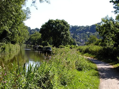

Thanks for the links, we are definitely in different environments! My nearest canal on the network is the Kennet and Avon. Here are some photo's to give you an idea of what it looks like. It's a pretty standard British canal, virtually the whole network of around 2,200 miles looks much the same, with most of it running through open countryside.
This a general view of a typical bit of the canal. The towpath on the right was originally to take the horses that pulled the canal barges along. Nowadays a lot of the towpaths have been turned into cycle paths, as they are pretty flat and make ideal routes for bikes, avoiding busy roads.
This gives a better idea of the width. Generally, most of the bridges are just big enough to get one narrow boat through, so will often have an opening of only around 7 or 8 feet wide.
