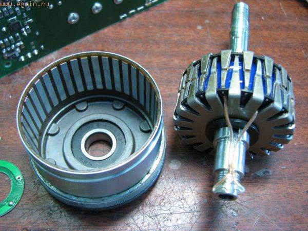

There's the Sineton design. That's two stator one rotor:
http://www.sineton.com/web/index-10.html
http://www.sineton.com/web/index-4.html
  • sineton_introduction.pdf
