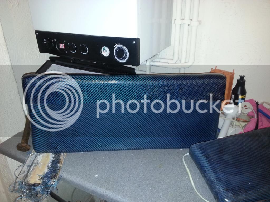

i created 2 polystyrene plugs these are the bases which measure 600mm long 200mm high and 50mm deep
i got some glass fiber cloth 300gsm and some epoxy laminating resin and a decorative black carbon and blue polyester cloth and wrapped my polystyrene plugs with i think it was 5 layers of 300gsm glass then wrapped them in the carbon/polyester cloth
i then added more resin layers and sanded/polished them up and then made my lids in a similar way with a 50x50x600mm with a 25mm piece on the bottom which i drew round my bases to create a lip to fit the bases i added 4 layers of glass to the top part excluding the 25mm lip then used some easy sand car body filler to level up to the 25mm lip then added another 4 layers of glass and then finally wrapped the lids in the carbon/polyester cloth then added more layers of resin, i had to do a bit of grinding to get them to fit properly but managed to get them to fit, i then drilled through each end and added an m5 rivnut so they could be bolted on.
i then got some u bolts which i had to modify and cut the threads longer added some shrink wrap and some 12mm aluminum tube to cover the threads and got some 30mm x 40mm car engine valve springs some locking nuts and some 30mm repair washers and made a bracket from 20mm box tube steel.
i then built a frame with 12mm box steel and some l brackets and some flat 2x20mm bar to mount my controller with some m4 rivnuts
then i drilled and fitted the bases to the frames using some m6 rivnuts
i drilled various 10mm holes and added grommets to link the 2 halves of the battery up and added a hole to put my charge lead through so i didnt have to keep opening and closing the lid and have rested the charge lead down the middle, i used some 8 core network cable for the bms link and shrink wrapped the bms and the connecting blocks i used for the bms links.
i put the lids on and have been for a test ride and its miles better without the heavy lump on the back lol
i was thinking maybe i could make a mold but they would be in 4 pieces then instead of 2 and make 2 u shaped box tube frames to join them and add some rubber trim to the edges of the lids to get a professional finish and maybe redesign the shocks to a mono shock design and use flat bar for the hangars to recoup some of the extra width this design would add to the battery cases making them 62mm deep, this would then enable packs of 8 a123 20ah prismatic cells to be fitted inside i think.
all i need now is a new bike rack lol and maybe a nuvinci hub lol
