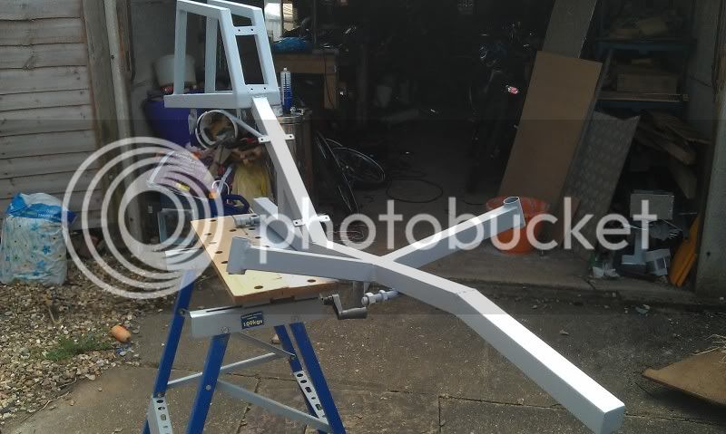

Ok, battery box is a fail. Comes far too close to the ground, and is too flimsy. Sooo, new build! Found a massive sheet of aluminium diamond plate in my gradads garden, so I'm using that. Had a redesign too to get it further away from the floor. Pics will follow, once I've taken some.
The ali is 6mm thick and damn, is it ever HARD ( thats what she said...).
I always thought ali was a nice soft metal, but I've gone through 4 cutting disks so far (versus 2 disks doing all the steel on the entire trike). Welding the ali has been problematic too. Tried Durafix rods but couldn't get the base metal to 390C, it just acted like a massive heatsink. So I cheated - two part epoxy putty for the win!

New battery box!
And installed ( bolts will be other way up ultimately).
Much better, still fouls the chain though. Now I gotta make up an idler...
Epic Fail! Ok boys and girls, it seems that I am a complete idiot!
When I made the alu batt box, i used a 2 part putty to stick the edges together. This stuff sets like steel.
I stood on the box and it held beautifully, so I'm like 'that'll do fine. WRONG!
Of course, that was under compresssion, with my mounting, the box was under tension.
So, I'm out crusing last night, trying out the new battery position. Handles great. Join a nice long cycle track near my house, blast past an old guy on an invalid carriage, and open her up. 41mph GPS verified. Slowing down, thinking I should check my voltages (speedict still not showing speed - grr), then all of a sudden my battery box disintergrates :evil:
I look back to see my precious lipo strewn out on the floor behind me.
Had to do the walk of shame 2 miles home :-(
Soo, new design
Fugly as hell, but hopefully it wont come apart!
