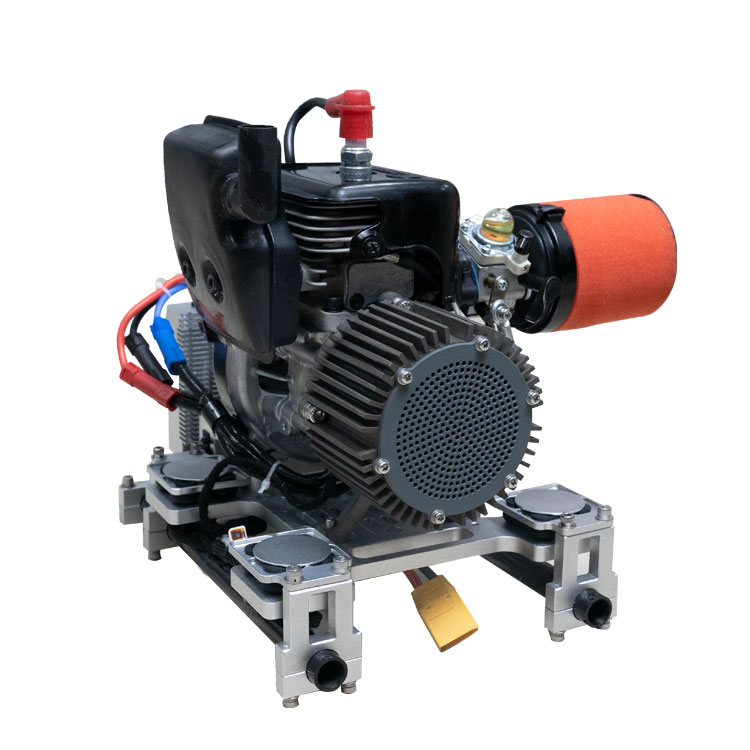

I went looking for drone generator as that fits the bill for power to weight ratio, if not quietness.
This is just a list. No idea how good they are.

Both. I'm building a custom trike out to be an apocalypse vehicle. The next body shell is designed to accommodate solar charging, I'll be able to comfortably sleep in the vehicle, and I'd like to have an ICE converted to run on ethanol or methanol or a diesel. I plan to use the traction battery as an energy source for heat as well as for cooking, and I'll require any onboard ICE to handle those demands without depleting the battery. The pedal drivetrain is also there as a meagre range extender and a last-ditch effort to remain mobile if all else fails, although with all this crap onboard, the unladen ready-to-ride full vehicle will be approaching 150 lbs.
The 5 horsepower or more is wanted in the case I want to cruise at 90 mph on flat ground, or need to briefly go faster so I can get away from the cops(this amount of power which will greatly extend my usable range and reduce my immediate need to charge). I've already used the coroplast velo in a street takeover with some Dodge Chargers. That was fun. Then with that much power, I can run the engine intermittently for what would be more typical usage cases, like riding all day long hundreds of miles into the boonies and not being able to find an outlet to charge, and only needing to deal with the engine noise/vibration for part of the time.
