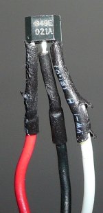

take a look at the pics, hopefully this will help.
i also included a pic of one of my throttle hall sensors so you can see it up close,
it uses red (pos), black (neg) & white (variable)
ok white is ground, thought that other picture was your controller. but it may be ruined already if it was reversed. maybe someone who knows about these linear hall sensors knows. it is the equivalent of the honeywell SS495 i expect from the label.

No. Black is ground, white is the output. These devices have the output on the end and the ground wire in the centre (see the attached datasheet).

Looking at the above posts/info and the link below appears to indicate the following connections:
Throttle Red wire (4.8v, hall sensor) = Controller (white connector) Red wire
Throttle Black wire (ground, hall sensor) = Controller (white connector) Black wire
Throttle White wire (variable voltage, hall sensor) = Controller (white connector) Green wire
http://docs.google.com/viewer?a=v&q=cache:upv-9VvI1eUJ:www.goldenmotor.com/e-Bike-DIY/Cruise%2520Controller%2520Wiring%2520Diagram.pdf+Golden+Motor+controller+wiring+diagram&hl=en&gl=us&pid=bl&srcid=ADGEESh66gNaERV5k3ly61kphc1x8aJ7b1QKLqcx45DOuDcFLQy-SjJz2ZLpdr9iaDV80n3lyHB3Bna9lzflB_XvS5u5gmc57I4qFUGTzBEhiX3NXCB6uFQjiC7K2FixFnAHolVfcq7Z&sig=AHIEtbRDg7kzVHLV1_O4JNctW-hRtKVyzQ
