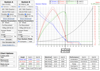

Do you know the windings for the two motors? You can model them in the grin simulator to see if the motors show the same speed difference.

Very few DD motors operate efficiently at super low speeds. That motor is designed for 1000w continuous.
You probably want a small geared hub motor.
Use grin's motor simulator for a guide on what motor is most efficient at such a low power range.
The tool is showing 21 mph for RH212 and 22 mph All axle using Full Recumbent. I believe both motor should have similar value.

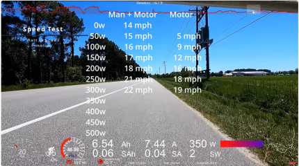

I verified my setup with Grin, and they confirmed that the speed I’m getting is normal. My previous RH212 test was done with an extra 30 lbs from two solar panels and a frame. I usually set my max to 200W for most of my rides, so this new experience has been somewhat disappointing. I’m just trying to see what results others are getting.. thanks!

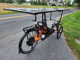

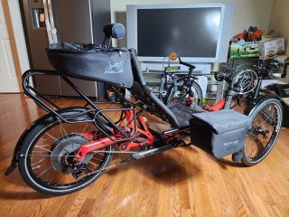

Can we get a good picture of your trike?
This is my new setup. Previous trikes were Catrike Road and Catrike Dumont with 30lbs extra weight using same RH212. I was expecting faster since I have not put the panels yet.

Hmm, the bike with the side bag is probably getting docked some aerodynamics points.
But DD motors are not known to be efficient well below their watt rating. They have an efficiency curve and you are at the worst part of it.
One difference between the two bikes is the diameter of motor and more poles on the RH212.
The RH212 is a lot more efficient at low rpm due to the difference in design.
Some combination of this and the side mounted bag is probably responsible for the differential

Side bag and rear rack were not installed at the time. I also tested additional 40 miles with the same result. I am trying to see anyone using the motor and hoping to compare. I do like the motor for much simpler install process.
Most of time, I set 200w since I get around 200w from my panels. I have not checked how fast I get for higher watts yet . My usual speed is around 18mph at 200w plus my input. The power cut off at 20 mph max. Thanks
