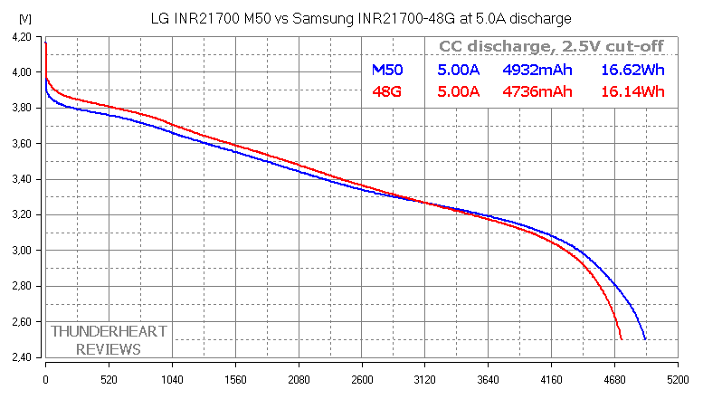

Hi guys! I've tested two high capacity 21700 cells - LG M50 (5000mAh) and Samsung 48G (4800mAh). The latter i had already tested before and the re-testing of another cell showed almost no difference with previous test results. The M50 is a new cell which is being sold as 10A one, but in its datasheet the maximum discharge current is mentioned as 7.28A. Nevertheless i've also discharged it at 10A to look at it's behavior.
The cells i've bought from Queen Battery.
As always, I've tested with ZKETECH EBC-A20 and a self-made battery holder. It's a PC-connected battery tester supporting 4-wire measuring and discharging at up to 20A.
I've followed all the prescriptions of the IEC61960-2003 standard concerning battery's capacity measurement. Before each discharging cycle each battery was charged at standard current mentioned in its datasheet to charge end voltage (4.2V) (cut-off at 0.1A, which is the lowest supported by EBC-A20). Before each discharging or charging i've held a 1-1.5hrs pause. The environment temperature was about 25°C.

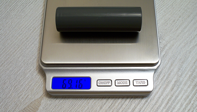

LG INR21700 M50 (Grade B)
This cell has absolutely no marking.

Weight (w/o washer): 68±1g
The measured weight is 69.16g.

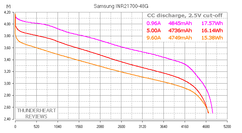

The main specs from its datasheet:
Typical energy: 17.4Wh
Minimum energy: 17.04Wh
Typical capacity: 4800mAh
Minimum capacity: 4700mAh
Nominal voltage: 3.6V
Standard charge current: 1.44A
Max. charge current: 4.8A
Charge end voltage: 4.2V
Charge cut-off current: 96mA
Max. discharge current: 9.6A
Discharge cut-off voltage: 2.5V
Max weight: 69g
The measured weight is 67.58g.
Test results:
At 0.2C (0.96A) the results are a bit higher than declared. At 5A and 9.6A the 48G showed good results with nice curves.

At 5A.
The results are very close, thought the M50 is better again.
