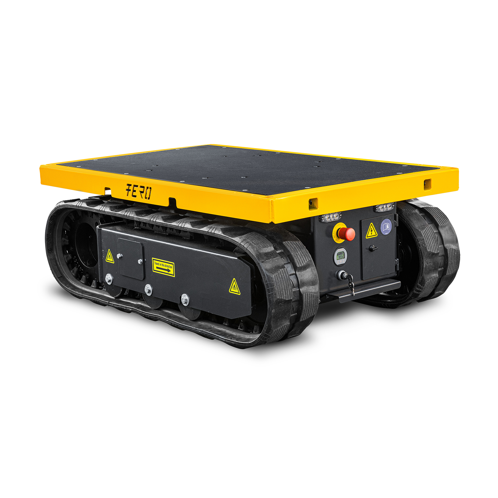

I'm planning on building a remote control tracked carrier robot to help on our homestead. We will use it to carry materials, plow snow, zamboni the pond in the winter, power tools all over the site with 120 V auxilliary power, power a winch for pulling stumps, etc.
I'm thinking something like this,

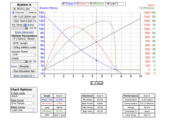

I was very surprised by how small the hub motors actually need to be. The simulator at ebikes.ca says that two RH212 hub motors will be able to climb a 20% grade, fully loaded (450 kg total weight, 225 kg per track), at 5.4 km/hr without breaking much of a sweat. Here i've set the track drive wheel diamter to 4", which seems reasonable.

I don't quite understand, are you using the rh212 as the hub of the track wheels directly? Or using some sort of gearing system/belt? Cause the RH212 is like 9 inches in diameter by itself so can't be a hub for a 4 inch diameter wheel.
That's a good point. I honestly hadn't thought about packing at all, I just chose a motor from ebikes.ca that I thought would work.

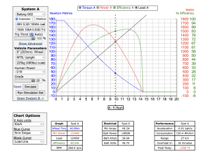

The plan would be direct drive. So that means either I increase the drive wheel size or choose a smaller diamter hub motor. Here is the Bafang G62 with an 8" drive wheel, and it also seems to work, with a higher top speed too!
I'm finding it a bit over whelming to select a motor. There's so many options and the seller never seem to list the specs that I want to see. That's why I'm using the ebikes.ca tool, but the motor selection is limited to the ones they carry. Even still they don't list the continuous current rating of the Bafang G62. Will 40 Amps burn this thing out? I don't know. If anyone knows of a decent resource for detailed motor specs please drop it below.
That is a gear reduced hub motor that can not drive in reverse.
Direct drive hub motors that can drive both ways and give you enough torque to do the job are going to be large in diameter like 10 inches or more.
A welded clutch could solve that. I'm not sure a hub motor is going to be the right motor for the job though. I feel like you'd be better off doing something more like a go cart with a central motor driving an axle with a gear reduction that can be carefully chosen. But I understand the appeal of the simplicity of hubs. Maybe a scooter or skateboard hub could work size wise but those probably wouldn't give you the torque you want. Grin also sells the wheelbarrow hub designed for lower speeds, maybe look into that.

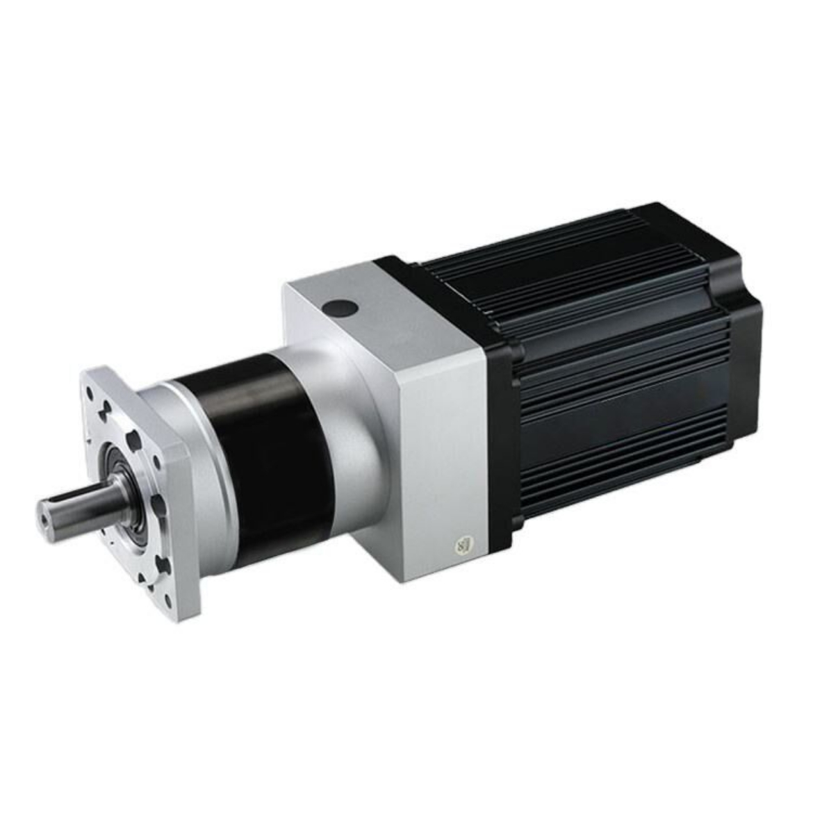

Maybe a motor/planetary gear box combo would work. Something like this,
This site also allows me to order it with a brake, which I'm guessing negates the need for my brake caliper/servo mechanism. I'm not sure if it's good to use outdoors though. Again, the site is very sparse on information.
Does anyone know of any commonly used motor/planetary gear box combos? If they have a built in brake and are rated for outdoor use I'm set!
Electric wheelchair motors are reversible and often use worm gear reduction. That gives the advantages of large reduction ratio and locking the wheels in place when the motor is not running. They are also small in diameter compared to hub motors.

All the wheel chair motors I could find are 500 W of less, likely too small for what I want.
The Wheel chair ( I picked a chair up for free a couple years ago) Motors I have are 1082W 24V gear reduction brushed Motors . Ebay has them or a Thrift store might have some. An actual wheelchair with 14" or larger wheels should have 1000W motors.

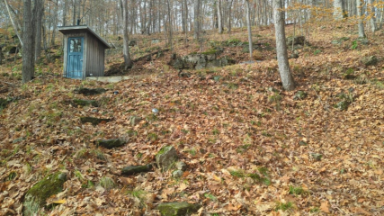

Thanks for your input everyone. After thinking about it for a while I think that perhaps it's best to not use tracks because they are difficult for me to build and I'm not sure how they would do over the very rough and rocky terrain that we have on our property (see below).
