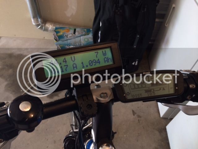

Since the pack is now remotely mounted, I took advantage of this to also install a Cycle Analyst meter which can now provide some long-sought info on the proprietary Ride+ performance.

And here's the analyst mounted on the bike.
The setup works great. I haven't drained the pack or even used a half of its capacity yet. I can report back once I get a much longer ride on the setup. I have monitored performance and found a number of interesting things regarding Ride+ performance.

Quite a bit more than the rated motor constant-duty power in mode 4. Above about 800W of current draw, my Ride+ motor gives a low humming sound. FYI.
With the system turned on, the steady state power consumption is about 7W (see pic, above). WITH THE BIONX SYSTEM OFF, current draw is in the range of 10mA. I confirmed this by monitoring with the Ride+ controller both connected and disconnected to the Cycle Analyst and the battery. This explains a lot. The BMS on the Trek system has long been suspected of being both a parasitic current draw as well as a terrible BMS. Both my batteries have gone below critical voltage with the Trek system, the BMS may very well be a contributor!
