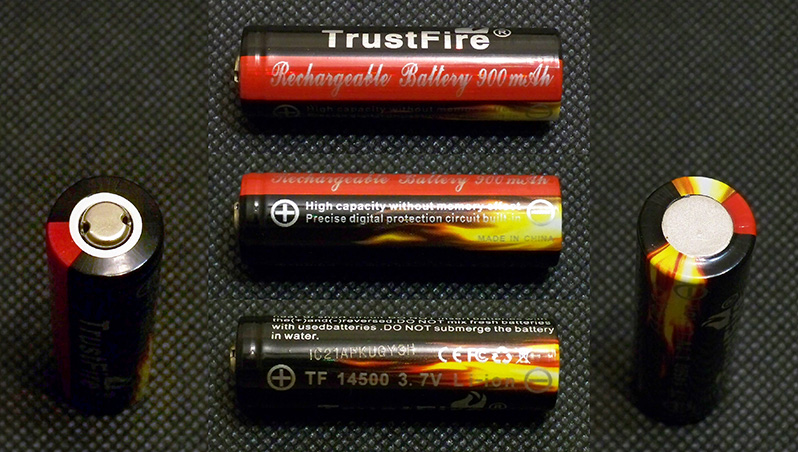

TrustFire 14500 900mAh
TrustFire has an official website: www.trustfire.com, but i wasn't able to find any datasheet for this cell. Each cell has a unique marking but i don't know what it means. The cell which i've tested has the following marking: IC21AFKUGY3H.
Look at the mention on the shrink tube - "Precise digital proection circuit built-in". I didn't believe it and i checked the presence of protection PCB after having done the tests. As i told, there is no datasheet and the only info available from the manufacturer is the 900mAh capacity and "Supports until 1000 recharges" mention on its website, which is not true of course

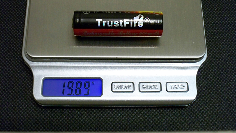

The measured weight of my cell is 19.89g and it's 14.0mm in diameter and 49,1mm long

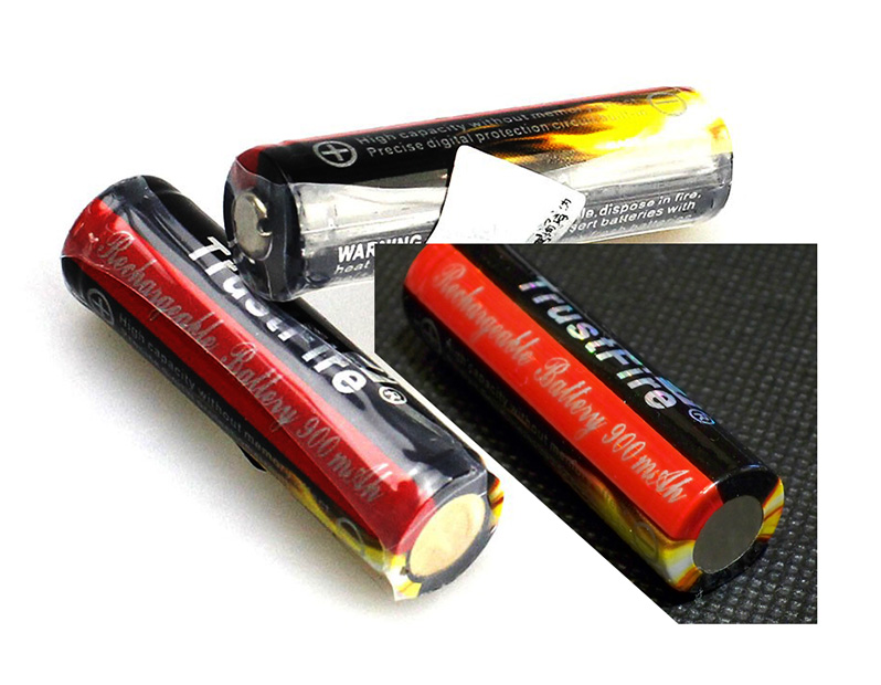

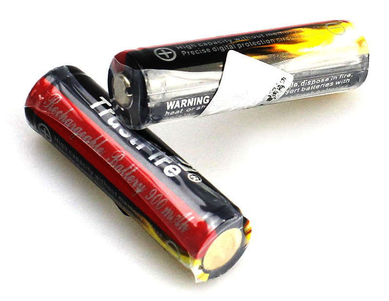

Now let's see what's there with built-in protection which the manufacturer claims it has. First i checked their website and found 2 versions of TrustFire 14500 900mAh battery - with protection and without. It was strange to see that TrustFire used the photos of protected cells on both pages

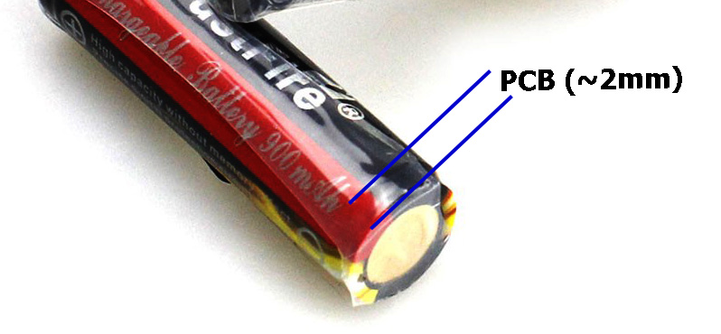

Can you see that yellowish negative pole? it's the contact terminal of protection PCB which is placed on the cell's negative pole. If you look better you'd see the groove between the cell and the PCB assembly.
Now let's compare official photos with the cell which i've got:
There are 2 differences: 1. my cell's negative pole is not yellowish and 2. there is no groove and additional 2mm space after "900mAh", so it's obvious that i've got the version without protection PCB but to be 100% sure i decided to discharge it down to 1.9V - a value which is far below the overdischarge detection voltage of any protection PCB. I did it at 1A and there was no protection to stop overdischarging, so my thoughts were confirmed on practice.
