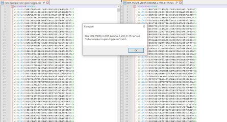

To be sure, I did another check with the version."OSF_TSDZ8_VLCD5_KATANA_2_V00_01.35.hex"
The compiled file on my computer and the file on github are identical.

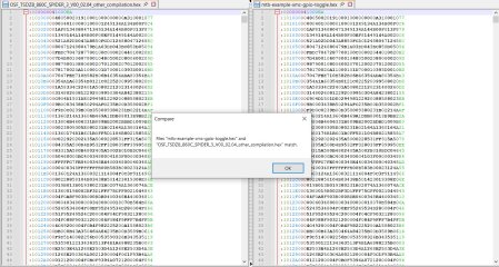

I did the last check again with the version "OSF_TSDZ8_860C_SPIDER_3_V00_02.04.hex"
The compiled file on my computer and the file on github are different.2026-05-02 215952.jpg
The compiled file on my computer and the file on github are different.View attachment 387756
I do not understand.
I just made a new compilation and uploaded on github under the name
OSF_TSDZ8_860C_SPIDER_3_V00_02.04_other_compilation.hex
Still I expect that it is the same content.
There was a different file on your github than ...other compilation.
The Google Drive file and the original file are the same.
I don't know.
But it can be seen that your incorrect one and my incorrect one are initially the same, only yours is shorter.

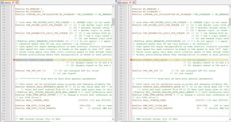

So I probably found 1 possible difference between github (prinf) and Onedisk:
In 1 of the main.h files, line 80 (//#define DYNAMIC_LEAD_ANGLE) is commented out.
Now I think it's fixed there. Or not? Which is correct?
Thanks for looking for the differences.
This line can't explain the differences in hex because this #define is not used any more (It was used in an #if in file main.c but now the #if is commented and so the parameter has no impact)
... now the #if is commented and so the parameter has no impact)
Yes, it does not affect the hex file.
