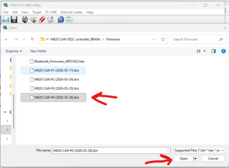

Now you can flash the bin firmware file:
1) Make sure ST-Link V2 drivers are installed if you have not installed it yet. ST Link V2 drivers can be downloaded here https://www.st.com/en/development-tools/stsw-link009.html
2) Download and install ST-Link Utility application for PC. It will offer to install drivers during installation, install those too. Here is the official download of ST-Link Utility application https://www.st.com/en/development-tools/stsw-link004.html
3) Connect the ST-Link V2 dongle to the BRAIN board P7(STM32) interface using the Tag-Connect cable and other parts I mentioned above and wire it following the pinout from the BRAIN board KiCAD files. (3.3V to 3.3V, GND to GND, SWDIO to SWDIO, SWCLK to SWCLK, NRST to RST). You can use a multimeter in ringing mode to check the pins on the Tag-Connect cable and where they go.
4) Stick the ST-Link V2 dongle to USB in your computer

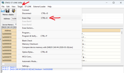

5) Launch the ST-Link Utility you downloaded and installed earlier
6) In the launched ST-Link Utility application click "Target-->Connect"
7) Then click File --> Open File and select the firmware bin file that you need.
8) Then click Target --> Erase Chip
9) After erasing process is complete click Target --> Program & Verify
10) Click the "Start" button and wait until it has complete flashing the firmware bin file and verification is done

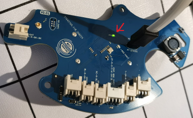

After some time after flashing is complete you should see the green LED turns on
11) Click Target --> Disconnect
12) Eject the ST-Link V2 dongle from PC and disconnect the controller

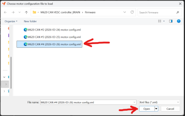

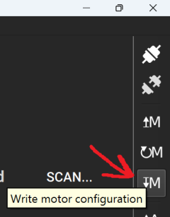

13) Now you should be able to connect the controller to the VESC Tool application ( you can use a USB-C cable (can connect without powering the controller up with battery), or Bluetooth (needs to power the controller up with battery or USB), or VESC Express dongle (needs to power the controller up with battery)).
14) After connecting the controller to the VESC Tool application apply the appropriate motor configuration xml file (at the moment the current motor configuration file is "M620 CAN #4 (2026-03-26) motor config.xml" )
File --> Load Motor Configuration XML
Select the motor configuration xml file you need
Click the Write Motor configuration button in the right side menu of the VESC Tool application

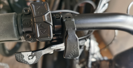

The new thumb throttle I planned to install has arrived and looks great! It works without issues. It is smaller than the original Bafang throttle and mounded with a split clamp without sliding it on the handlebar which is very convenient.
The controller with the throttle does not make more power on my setup with 14S battery, the top speed with throttle alone is just about the same as with pedal assist alone. It can make more power with throttle though if you will use higher voltage battery and the motor RPM will overcome the cadence you can spin the pedals with (on the VESC M600 and the VESC M560 controllers with 16S battery the controller can spin the motor faster than I can keep with it up)

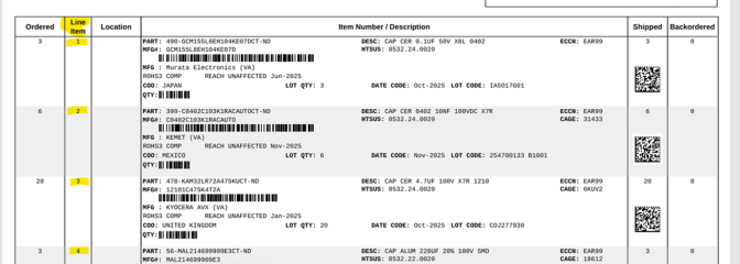

1) If you ordered the parts using the links from the KiCAD files I posted I specified those mostly from DigiKey for convenience. There are some parts from different suppliers, but most of them from one (DigiKey). So go the DigiKey page with your order and download and open the Packlist PDF file with your ordered parts and download other suppliers packlists).
2) Sort the bags from DigiKey by the bag numbers so you can quickly find parts in the bag with the number you want by the bag number. You can organize those bags by the numbers in a bin for instance, here is an example:
The bag numbers match the Lina Item in the DigiKey Packlist.

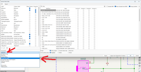

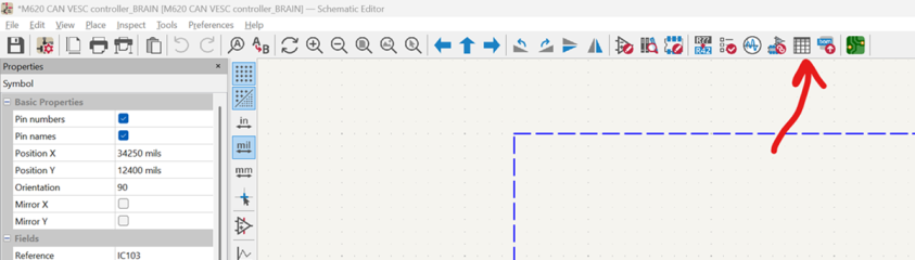

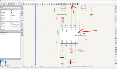

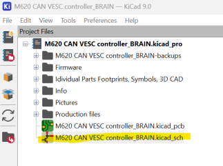

3) Open the KiCAD program and open the PCB project file you are planning to solder. Open schematic
Open the Edit Symbol Fields
Select the View Preset and select Grouped by Value
Close the Edit Symbol Fields and open the Schematic Editor

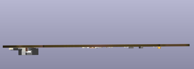

Open the 3D View

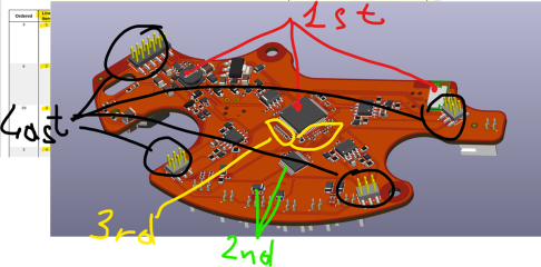

4) Look on the 3D view and plan how you are going to place your components. I recommend to start placing big low profile components first (like inductance coils) and go smaller and smaller (from big diodes, resistors, transistors, capacitors etc to smaller diodes, resistors, transistors, capacitors etc). The last thig you want to place on the PCB is the tall components like USB connector, headers, etc.

7) To start placing the components in organized manner and to track them see on the 3D view and notice which component you want to place, let say this one
8) Notice where the component is go to the PCB editor and click on that component. (I recommend to turn off the footprints from opposite side of the board and turn off other stuff and layers to see what you want better and to pick want you want easier).
Select footprint of the components you want to place and click on the Schematic Editor icon
9) The components you selected in the PCB editor will be centered in the Schematic editor, click on it and click on the Edit Symbol Fields icon

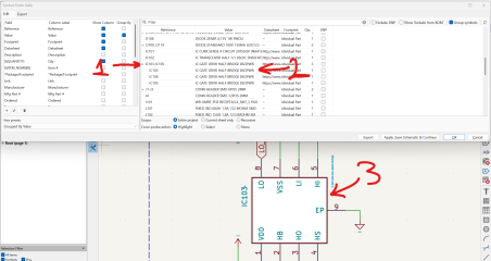

10) In the opened table the group with the same components will be highlighted. Expand the group to see all the components with the same value (same components), click on the value and copy the text (Ctrl+C). The component you clicked in the table will be centered in the graphic view of the Schematic Editor, click on the component in the Schematic Editor and Alt+Tap to the 3D view window
The component you clicked will be highlighted. This is where you should place the next component with the value you just copied text of.
11) Go to the opened Packlist PDF file from DigiKey and find the component with the value you copied (Ctrl+F, then paste the value using Ctrl+V, then press Enter). See the Line Item number of the component. This is the number of the bag with the components you go and take.
Be careful and do not pick the number accidentally from the "Ordered" column instead of the "Line Item" column!

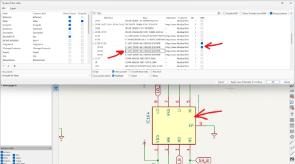

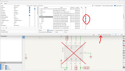

12) Place the component on the same place highlighted in the 3D View.
Pay attention the component orientation! If it is a diode, or an integrated circuit, it a polarized capacitor etc watch the marks on the components, watch the marks on the PCB and watch the marks in the 3D View to properly orient the part.
Alt+Tab to the Schematic Editor in the Symbol Fields table and mark the component you placed as DTP (which means do not populate). Click on the next component with same value in the Symbol Fields Table and click on the centered component in the graphic view in the Schematic Editor. Alt+Tab to the 3D view again and see the next highlighted component with the same value you need to place. Place it and go to the next one the same way. Of the component is on opposite side of the PCB to not place it of cause and do not mark it as DNP.
13) Once you place the component with the same value on the PCB and marked the placed conponents as DNP in the Symbol Fields Table click the "Apply, Save Schematic & Continue" button and Alt+Tab to the PCB Editor window
14) Update the PCB from Schematic
15) Go to the 3D view and check the components you placed are disappeared in the 3D view

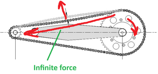

We recently explored a weird behavior of the controller on the throttle on stand still bicycle. I did not know such behavior exists because of I never used throttles on stand still bicycles or VESC controllers before, but other people who also fabricated and tested this controller noticed it.
I tested the controller today with throttle on a real ride to check it and I found if I stay still on the bicycle and start pressing the throttle (even slightly) the motor hits the transmission and backs off, then hits the transmission over again and backs off again and do it jerking back and forth over and over like an impact wrench and almost does not move the bicycle (well, maybe moves it a little). The motor can hit the transition quite hard doing it's jerking thing. If I roll the bicycle even slightly and then press the throttle the motor starts working normally.
I tried the throttle curves, the throttle voltages limits and other throttle adjustments with slow response in the VESC Tool and it did not help (while it does make it softer if you use the throttle on the rolling bicycle it still can start jerking on stand still bicycle). Also even if I press the throttle just slightly and very carefully from stand still is still can start jerking.
I never was able to achieve such jerking behavior using pedals (with the pedals the motor does not start working before you start cranking the pedals at least a little and when you cranking the pedals the bicycle obviously is moving already and the motor starts working without issues). The pedal assist mode had never issues for me.
The people who use this controller also reported the throttle works fine if you select "Duty" mode on the VESC Tool. I did not not test it, but as I understand the pedals assist does not work in the mode on the Luna firmware.
The assist level on the Bafang display and the power you set in the VESC Tool also affect that "impact wrench" behavior. In the Eco mode the throttle starts spinning the motor on stand still bicycle without impact wrench behavior for instance.

DUTY CYCLE will work with the torque sensor if you put it in PAS only, go to APP SETTING>GENERAL TAB>APP TO USE and put PAS but the throttle won't work its either one or the other. IF you go to APP SETTING>ADC>GENERAL TAB>CONTROL TYPE you will notice that DUTY CYCLE has NO REVERSE BRAKE ADC2 option like CURRENT mode and I think that's why the throttle and torque sensor doesn't work. When you choose APP SETTING>GENERAL>APP TO USE AND PUT ADC AND PAS both work in current mode? I tried every setting in Current mode and the only way to stop that clunk is to tie wrap the rear freewheel which is not the best setup.
Another alternative is to obtain the VESC based INNOTRACE X1 firmware from Krasnodar and integrate the Krasnodar code into the Luna firmware if Marcos does not want to fix his stuff. Now I feel like this VESC firmware behavior is the reason the VESC guys so obsessively demanded the INNOTRACE X1 firmware to see how Krasnodar resolved that throttle jerking behavior of the VESC firmware.
Here is what happens. If you have some slack in your drivetrain the top portion of the chain is slacked down under the gravity force. Plus the motor gears transmission has some slack. When you press the throttle from stand still and got some slack the transmission gears slack allows the rotor of the motor to build some kinematic energy and quite high RPM before it removes the slack in the gears of the motor transmission. Once the slack in the gears transmission is over it starts pulling the chain. When you pull the chain you remove the chain slack but the chain gains some kinematic energy and starts moving up and passes the straight line position and starts pulling the chainring in opposite direction with infinite force (because of the angle between chain kinematic force and the chain line is 90 degree initially). The opposite side of the chain rests on the cog and the whole bike and rider inertia force hold it back. Because of there is quite high gear ratio between the chainring and the motor rotor even light motion of the chain in the opposite direction causes the motor stator rotates back instantly and noticeably no matter how much speed and torque the motor stator gained because of it fights with infinite force initially through quite rigid motor gearbox with no clutch or anything. As result the motor gains quite high RPM, then instantly stops and bounces back with infinite force and quite high RPM gaining kinematic energy in opposite direction (the M620 rotor is quite heavy) because of the chain and the gearbox. VESC controllers never dealt with high gear ratio gearboxes with slacks and chains without clutches and possibility rapidly being bounced back with infinite force withing split second so whatever the control algorithm VESC firmware uses it is not prepared for such scenario.
Tried adding DUTY CYCLE NO REVERSE BRAKE ADC2 to VESC firmware with but was not successful hopefully someone could figure this out?
What is the chainring size you use? You might try to install smaller chainring (like significantly smaller, maybe about eMTB size chainring) and that might work as a band aid solution.
Yes It rachet so hard once it broke my clutch bearing, for a band aid solution I put a tie wrap on the rear cog to the spoke to keep the rear cog tight.
OK, just for the record I use pretty big and heavy 46T steel chainring with M620. I did not test the throttle from stand still on other ebike with INNOTRACE m560 controller or VESC for M600 controller with small chainring though, but even if it works OK it might be not a completely correct comparison due to modified firmware, smaller motor size and different gearbox.
