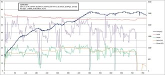

Following a recent ride I found the fan to be warped due to temperature increase. The fan material seems rather vulnerable to heat. I added an aluminum plate to the exterior which should prevent it from warping. Here is another chart for yesterdays ride (without the plate). It was a 5.5 mile ride averaging about 1700W and the motor did not exceed 80C. :lol:

I pushed the bike a bit further today on a 3.5 mile run using 7th gear and averaging right around 2kW with 3kW peaks. Motor temperature reached lower 80's (C) and the aluminum plate on the fan did the trick - no warping. I got some video this time and integrated the data using RaceRender 2 (free edition). Synchronization is not perfect and may have something to do with relying on the CA to send the data accurately at 1 Hz as that's what I am currently using as the time stamp. I can update the code so that it uses the data loggers clock to stamp the data. This and a 5 Hz update rate might make things a bit smoother. I'll post the data graph later but for now here is the video (limited to 3 minutes in free version). Note toward the end the A-hole who decides to pass at the worst possible time.
