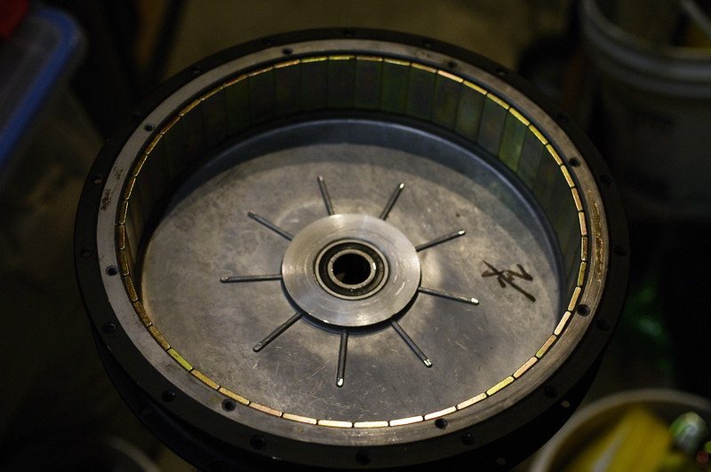

my speedo is about 3-4 mph under, when I change to 20 pole it evens out with my brothers motorcycle speedo alongside me...
Not exactly unheard of for speedometers to be "calibrated" to read faster speeds than the vehicle is actuallly going, so most likely yours is accurate and his is not.
ABritInNY said:
When my wheel is set as 2160mm (measured with string) and 23 pole pairs my speedo is about 3-4 mph under, when I change to 20 pole it evens out with my brothers motorcycle speedo alongside me... Are we sure the 1500w leaf has 23poles as the CA v3 setup? why is my speedo wonky then? confusing...
instead of the string method, it would be more accurate to measure the radius with you sitting on the bike. than calculate the relevant diameter ;)
+1 looks like 23 pole pairs
Yes Guys I can count :) 46 or 23 pairs, tbh this was the first pic Ive seen (that I remember) where ALL the magnets were visible to me, (none chopped off at the bottom where I guestimated) I've since set it back correctly to 23 and will have to try other methods to reconcile the speedo with other vehicles (or accept it's accurate when it doesn't feel it.) Guess it's the wheel re-measuring next... thanks for all the help though, it's much appreciated in narrowing this matter down.
