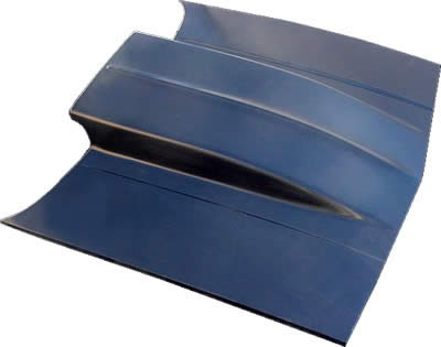

I plan to add intake vents on the wire side, and exhaust vents on the perimeter of the housing on the cylinder between the disks with the spoke holes. This leaves the gear side undisturbed. I'm soliciting opinions for the shape of the exhaust holes. The reason I bring it up it is the air flow will differ significantly from ventilation of a direct drive hub, because the exterior housing spins one direction with an ID of 112mm, but the magnet bell of the motor spins the other direction over 4 times as fast with an OD of 100mm. That puts it in close proximately with the exhaust vents on the housing.
I believe that once air gets inside the housing that the direction of the bell spinning will dominate. I want to taper the exterior of the exhaust vents to create a low pressure region from the spinning housing relative outside environment by tapering the trailing edge. I'm unclear how to shape how best to shape the interior edges of the exhaust vents. It's all aluminum and fairly thick, so I can get a nice shape to stimulate the best flow.
