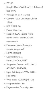

I want to buy controller, I see different types pro, versions
With aluminium pcb without, different firmware versions, price
Which should I Try?
Or is 75200 better?
And it's not watertight. For e-bikes necessarily.
And problems with overheating, are maybe cooling fans needed?
+/- 70V x 70A max.
Which should I Try?

I saw on flipsky website tft screens
I read that also bafang screens working
Brake, lights, horn, all these things don't need done by an controller
I saw info that some flipsky controllers doesn't firmware upgrade, but on vesc information stays how to upgrade
ADC makes it more easier, what is ADC?
There are standard, pro version and v2
The first looks easier to make watertight and the cheapest.

And there is also bluetooth, can they all work with bluetooth module?
And version anti spark
And water cooled version
Are there overheat problems 🤔
Can surround with cooling fins
Any VESC can work with a bluetooth module, some have it built in.
Honestly though I would buy a spintend or a MakerX which are only very slightly more expensive and much better made. As many have experienced the flipsky VESCs do work but not always well so can be down to luck if you just plug it in and it works of you have to tune it to get it work well, better designed VESCs can still require tuning sometimes but it's less likely. Depends on a lot of factors as to how well it will work.
I use a spintend with bluetooth and ewheel adapter.
The packaging of the controller sucks but it's a very nice unit and very compact for the power it can put out.
No flaky stuff to think about when programming it, well documented and supported. Worth the extra coin.
