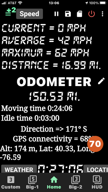

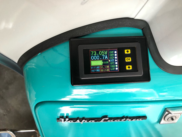

Another ride, quick stats:
23.4 Miles
31.6 MPH Moving Average, some stop and go for the first 5 or so miles, the rest at 40-45 MPH, mostly, some > 50, max 56 MPH.

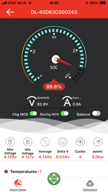

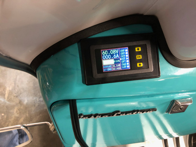

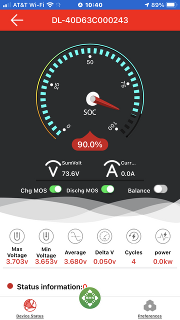

Starting voltage: 82.5V (95% SOC)
Ending voltage: 70.0V (40% SOC)
Total battery capacity used 55%.
Extrapolated range, 42.5 miles, for "reasonable riding". This is pretty much spot on Jim's 43 mile range prediction.

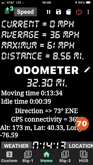

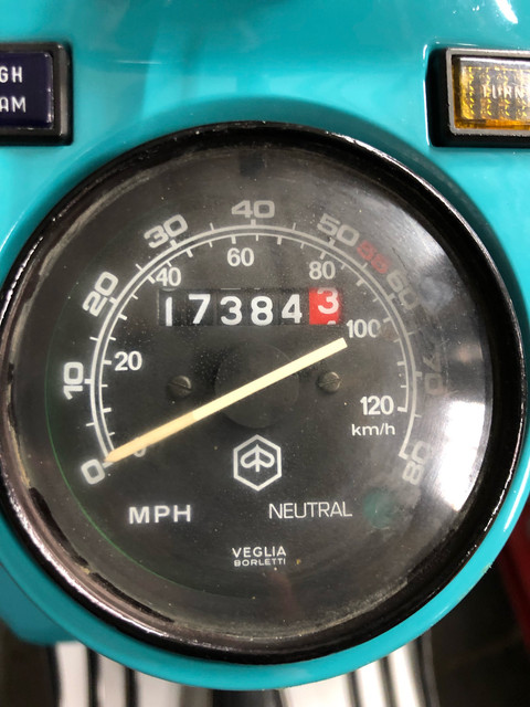

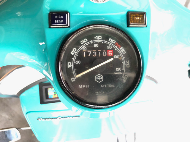

I put my phone with a GPS app running in a map pocket on my sleeve and made mental notes of actual vs. indicated speeds on the speedo. The speedo largely reads 5-7 MPH high, no matter what speed. So, at least now I have a reference, and know how fast I'm actually going at any given time.

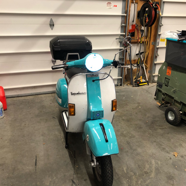

Just ordered one of these:
https://www.scooterwest.com/px-stella-rear-rack-for-top-case-px29.html

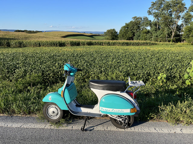

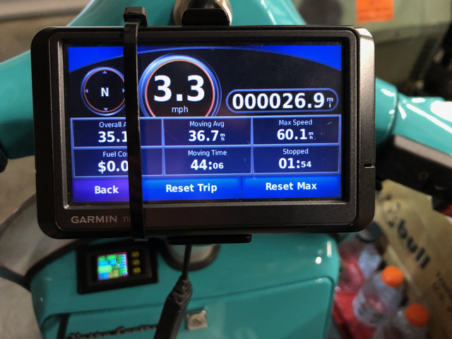

I did an out and back on some rural farm roads. I turned around at 13.4 miles. It was getting close to dark, and I
know that Jim ran the battery out at 28 miles once, so, I didn't want to push it beyond that.

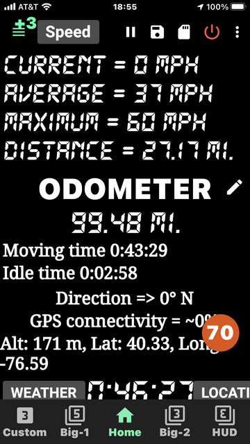

Ride Stats:

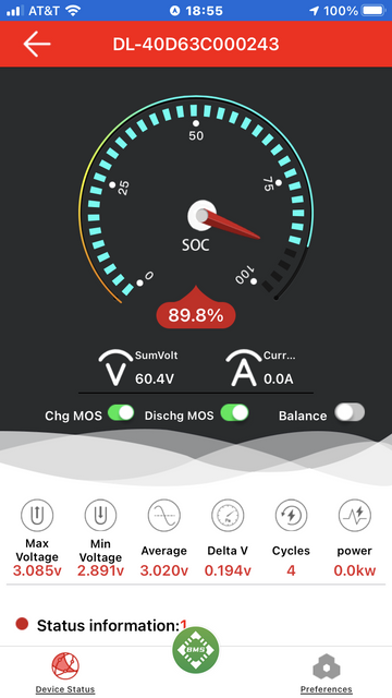

Starting voltage: 82.8V, 95% SOC
Ending voltage: 60.4V, 0% SOC
Distance: 26.7 Miles
Moving Avg Speed: 37.6 MPH
Max Speed: 60 MPH
For most of the first 3/4 of the ride, I was doing between 45 and 50 MPH (GPS measured), with occasional 55 MPH, and
one runup to 60 MPH. As the numbers show, I used the whole battery range.
I had to baby it up the hills for the last 5 or so miles to keep the voltage above the 57 volt BMS cutoff.

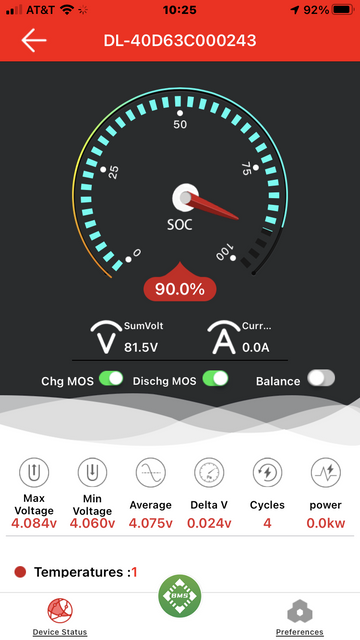

So, I think I've established that a safe operational range for it with this battery is about 25 miles. The battery monitor is a very nice feature to have, I highly recommend it for anyone considering an EV conversion. Keeping an eye on it definitely helps manage the battery level and range, and likely will
prevent being stranded with no power, as knowing how much power is left lets you manage that power, and back off if need be to make it home.
More observations. At 40-45 MPH up even gentle hills, the motor draws 80-120 amps (6-9kw). If this motor
only put out the "rated" 4KW, this would not be very fun to ride. Thankfully, it can handle a lot more, and the battery can provide the juice. It draws 180-220 amps up steeper hills if I maintain my speeds (up to 15kw!).
Based on the ride data that I've compiled thus far, I'm consuming between 80 and 100 Wh per mile. This particular ride, it was 100 Wh.

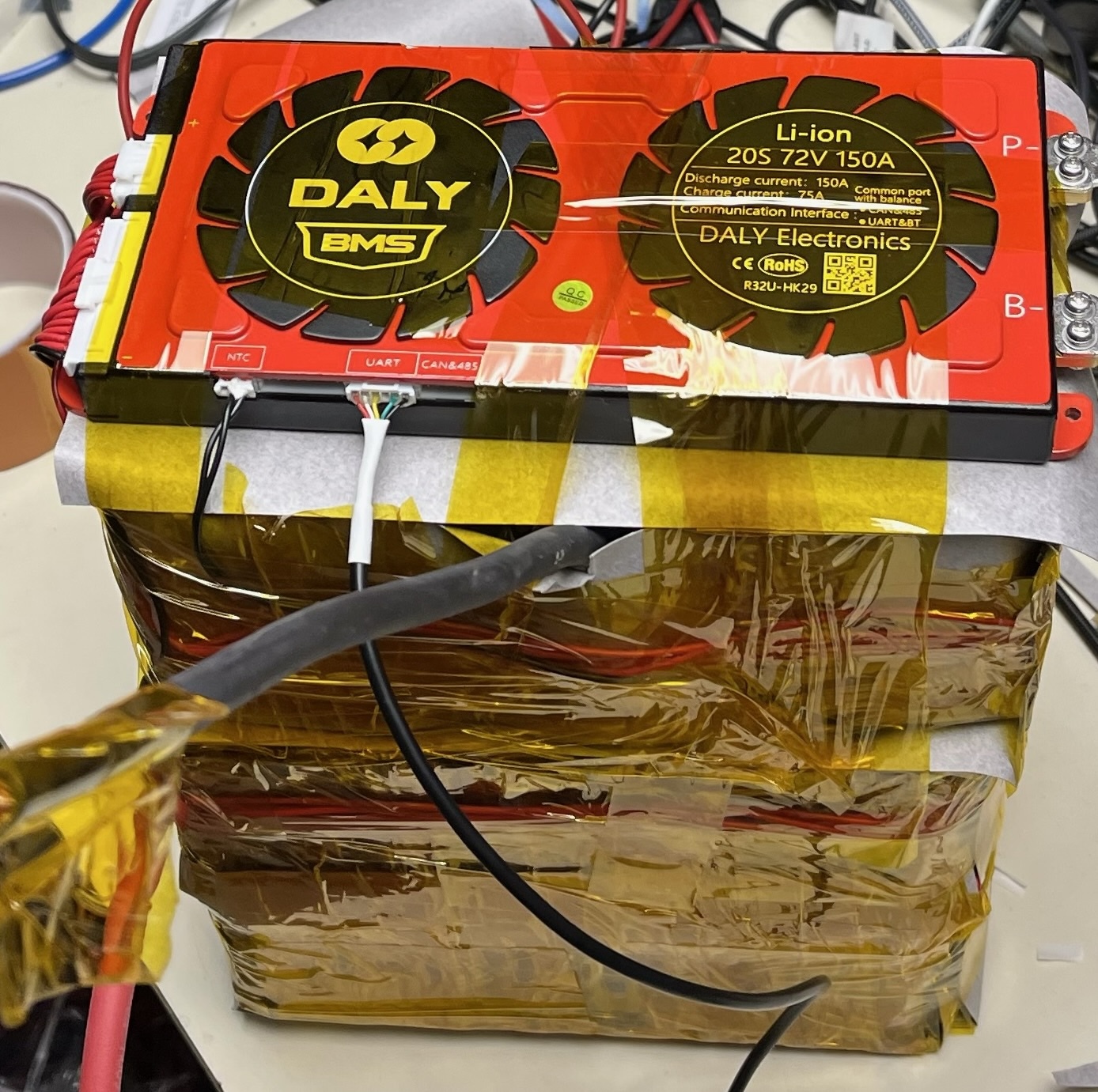

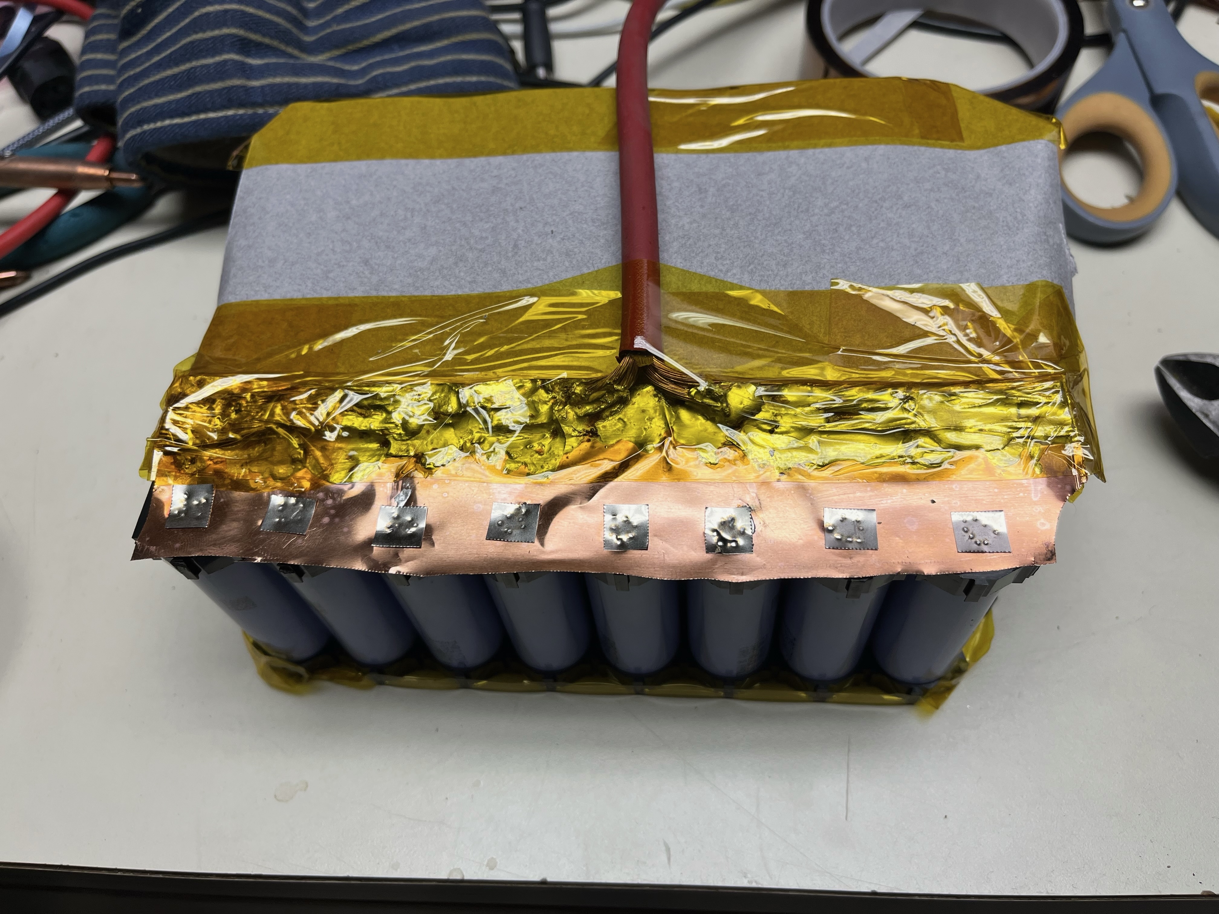

For anyone considering an EV conversion, there are three things to consider with your battery selection. One is of course, voltage, the next is the instantaneous AMPs it can provide, the final one is Ah (Wh = Ah * Volts). I'd use 100 Wh per mile as a baseline for range. If you're going with the "4kw" QS205 motor, then 72V 38ah is probably the minimum sized battery that you'll want.

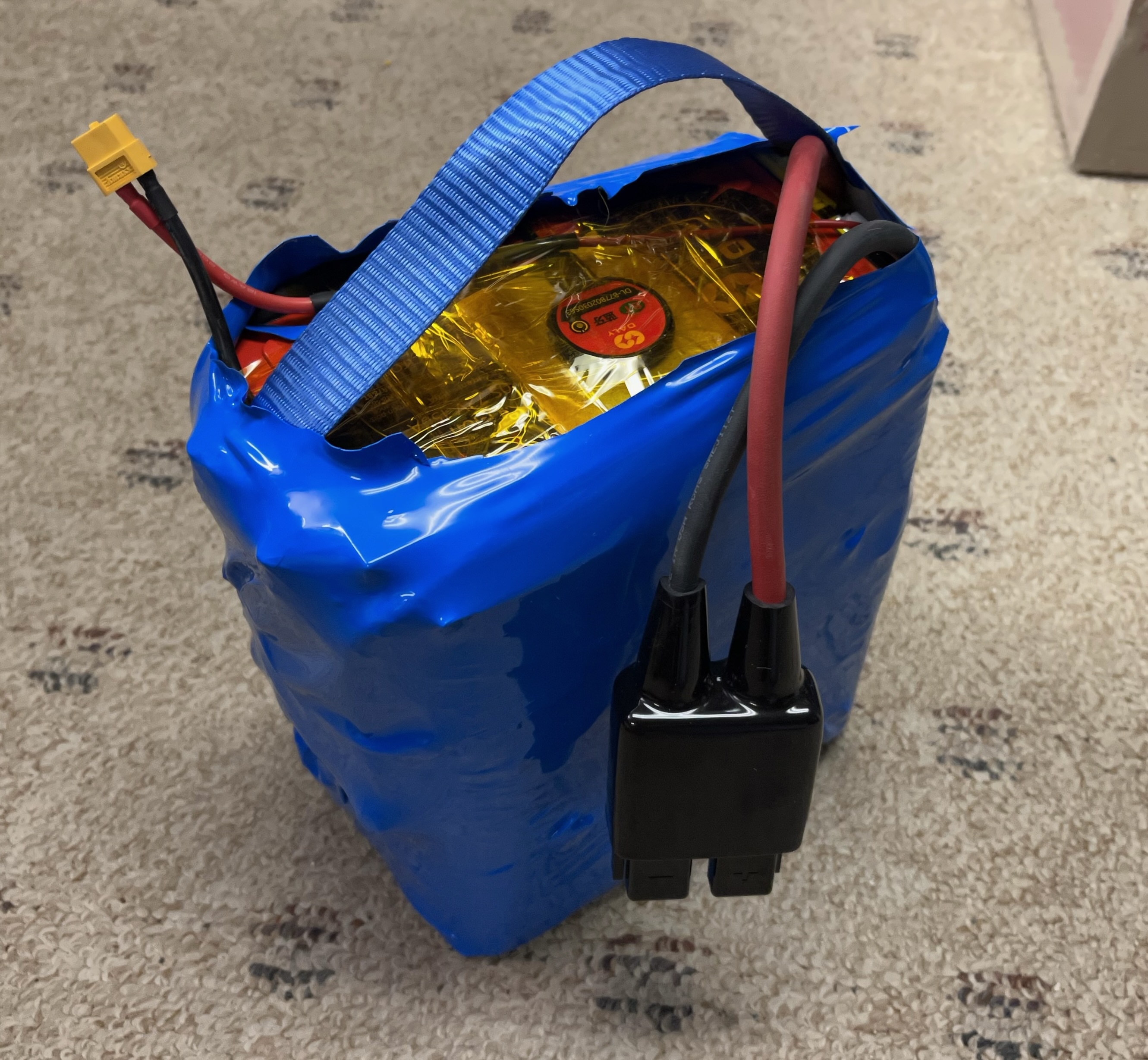

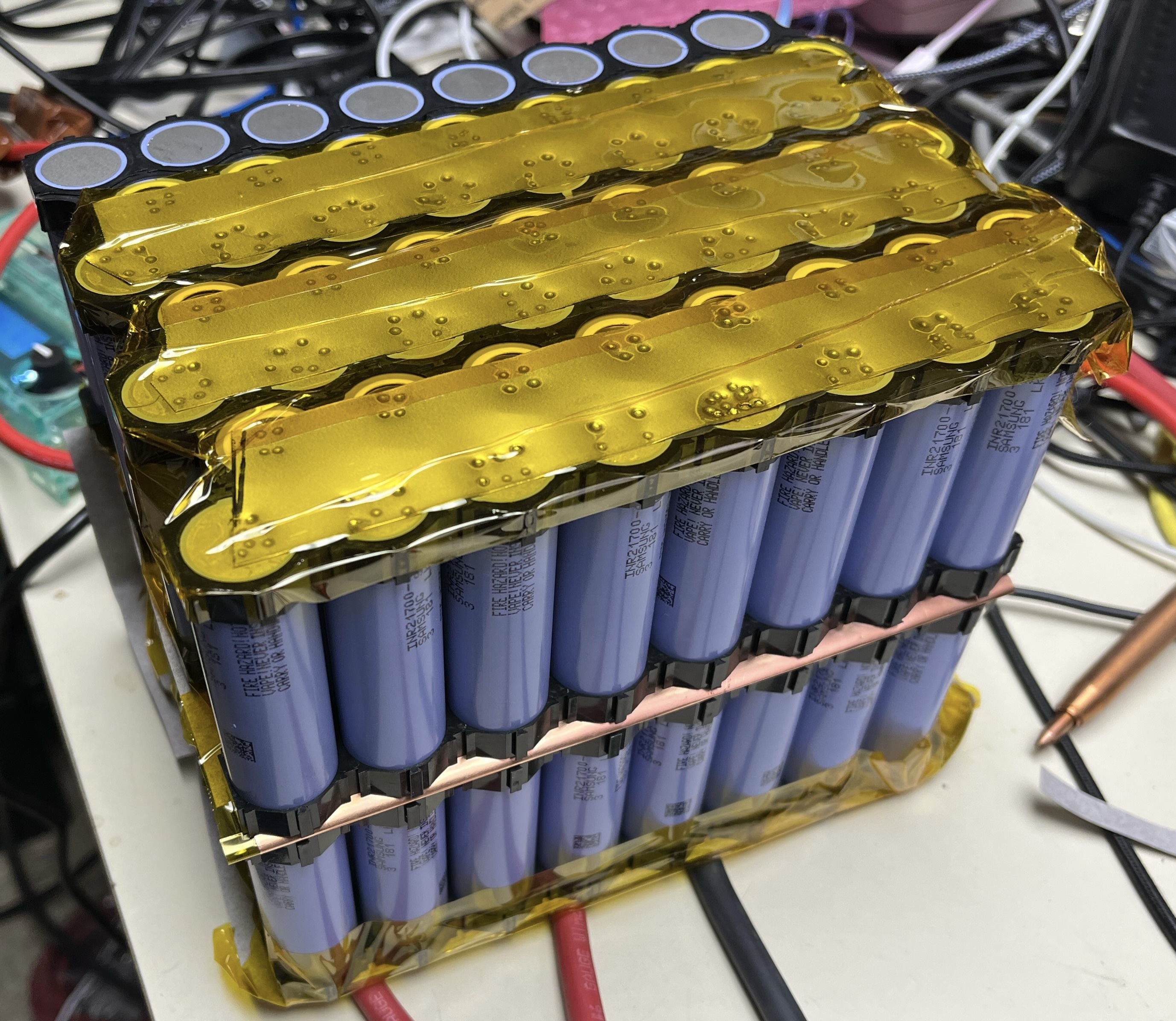

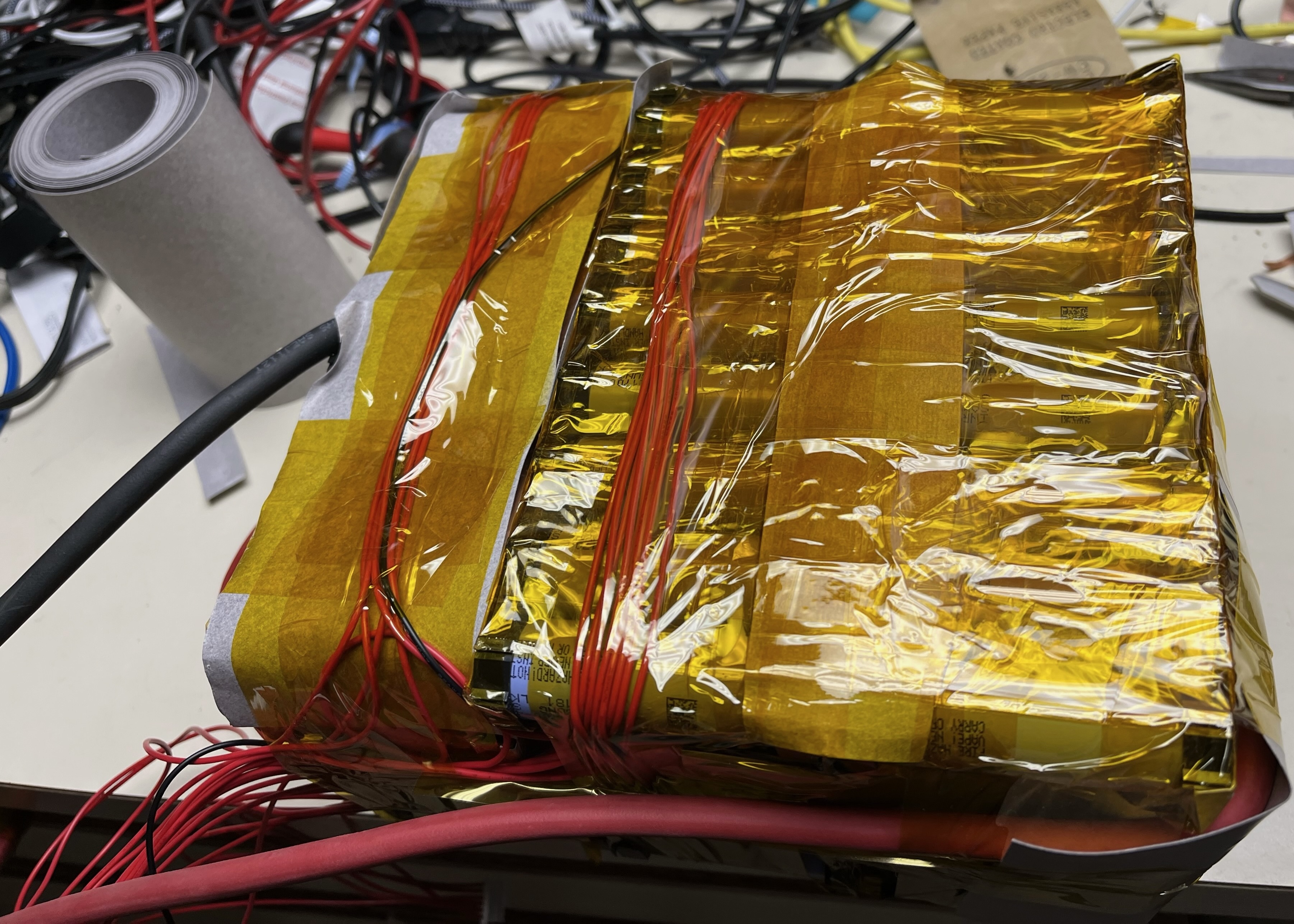

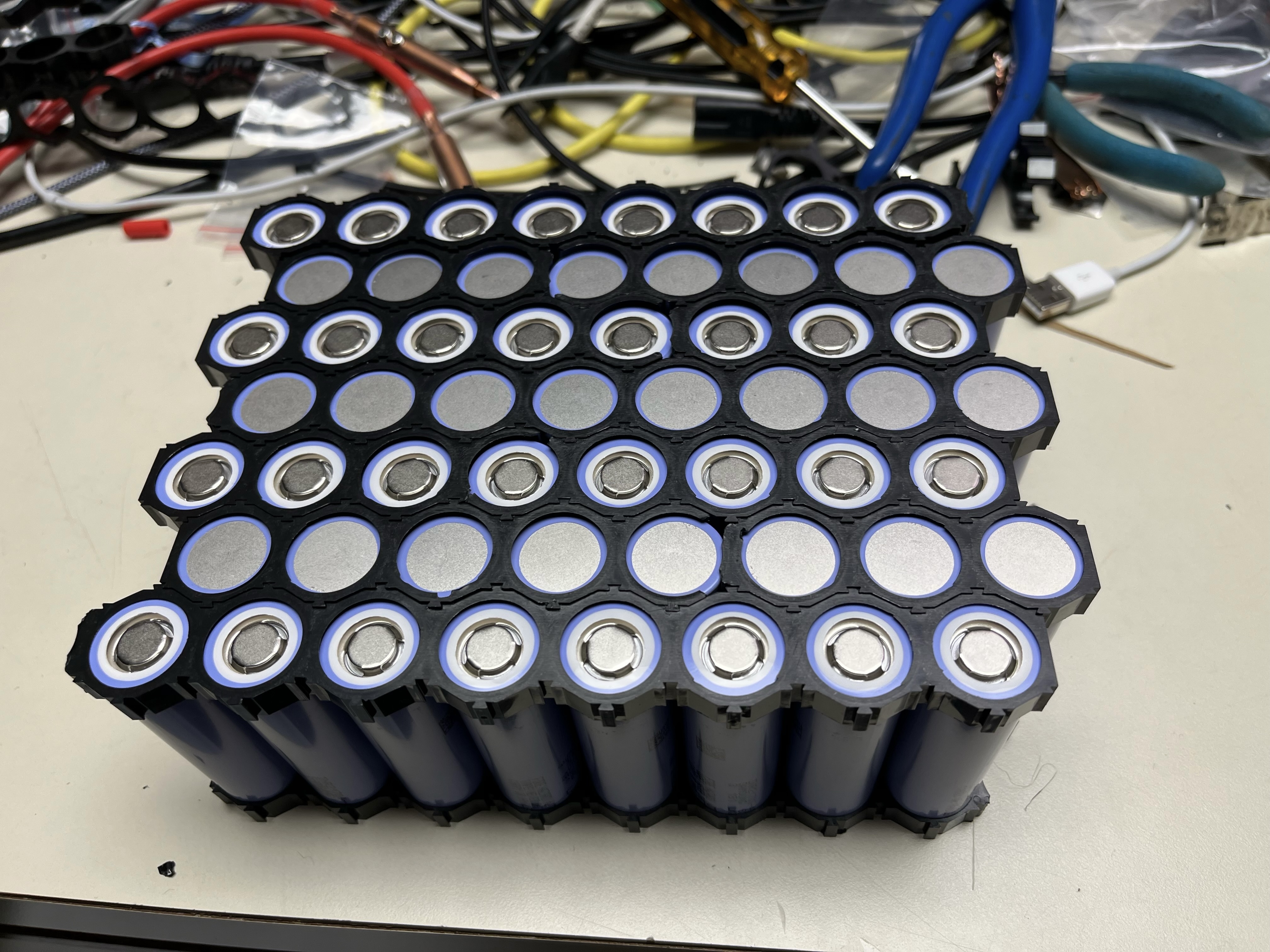

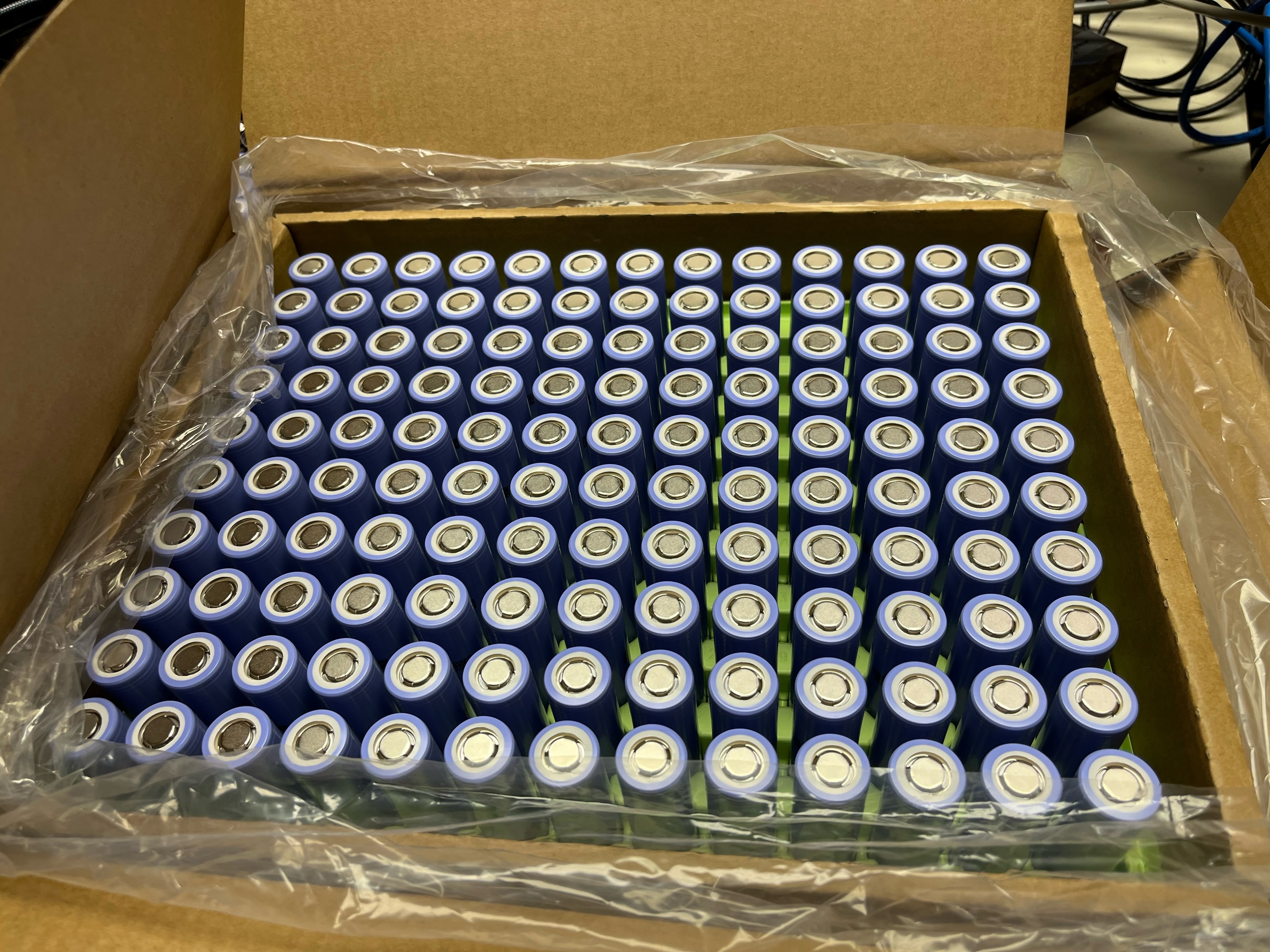

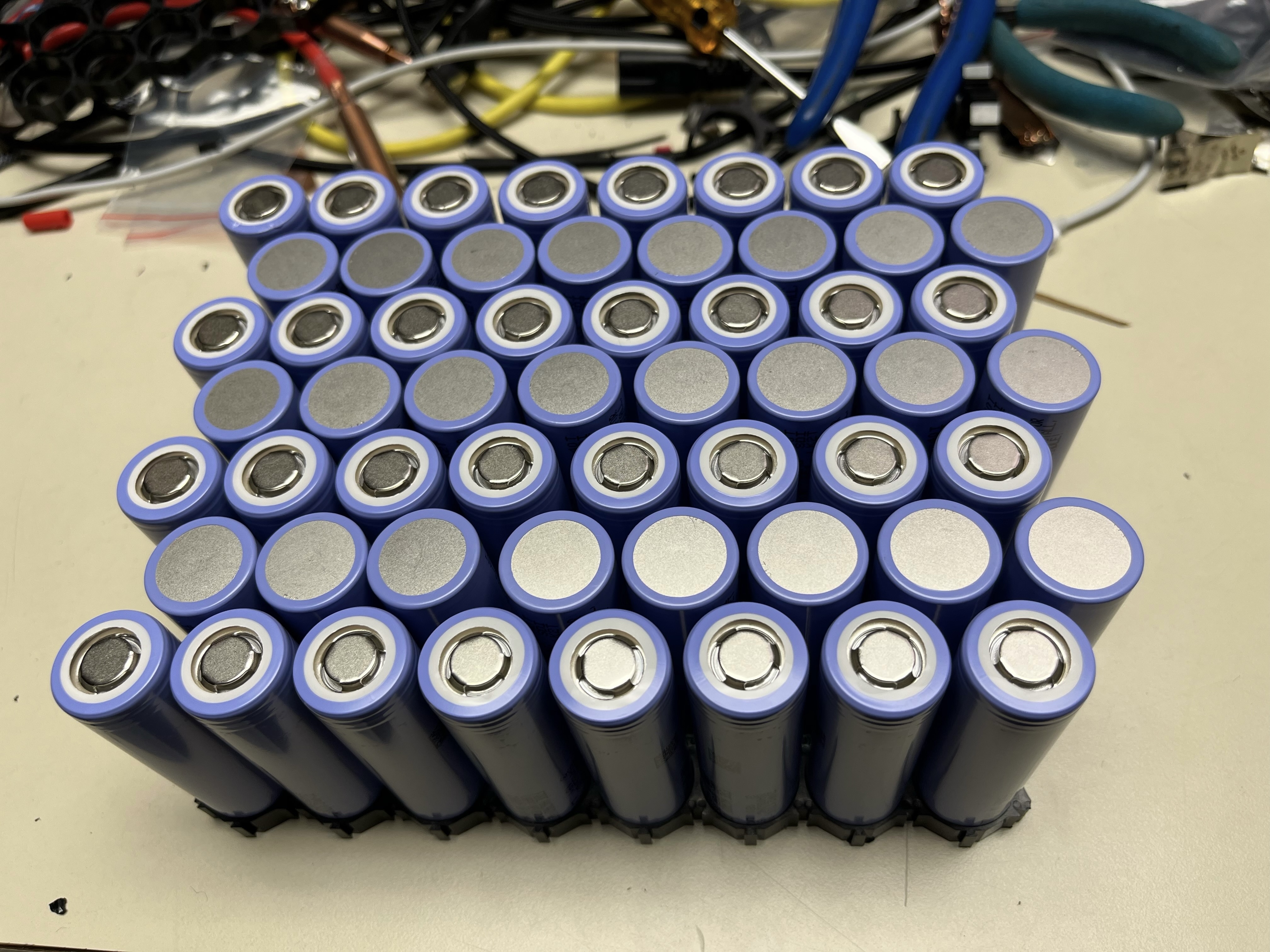

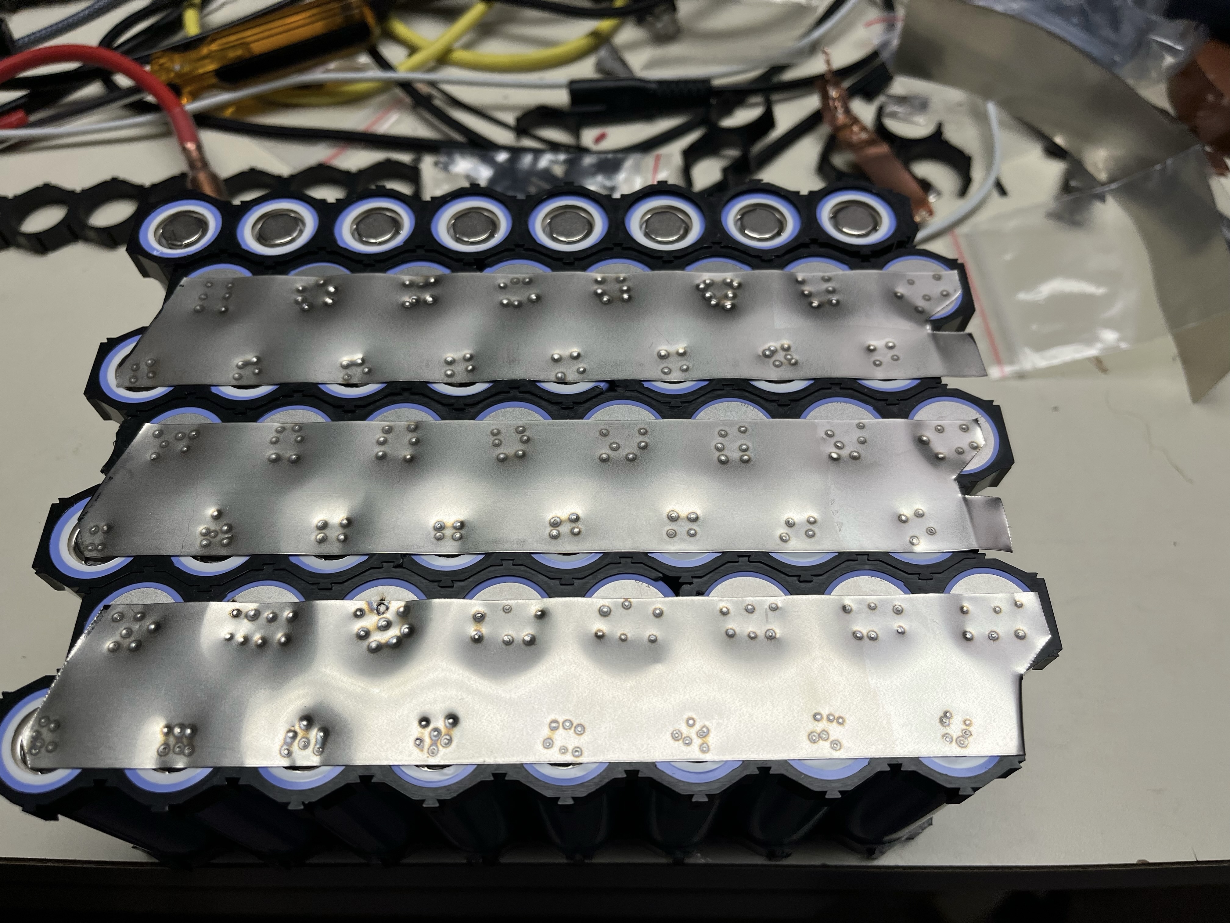

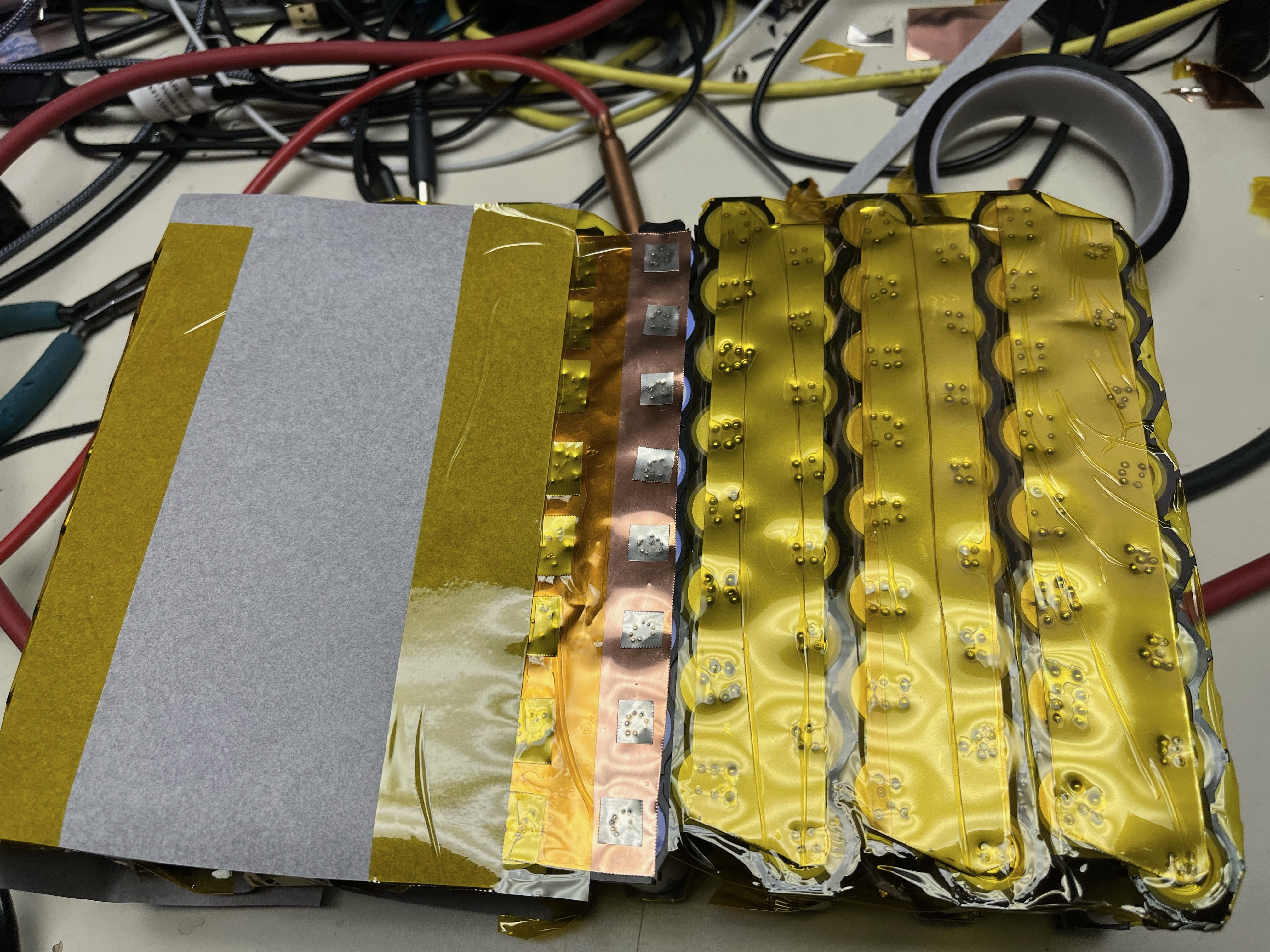

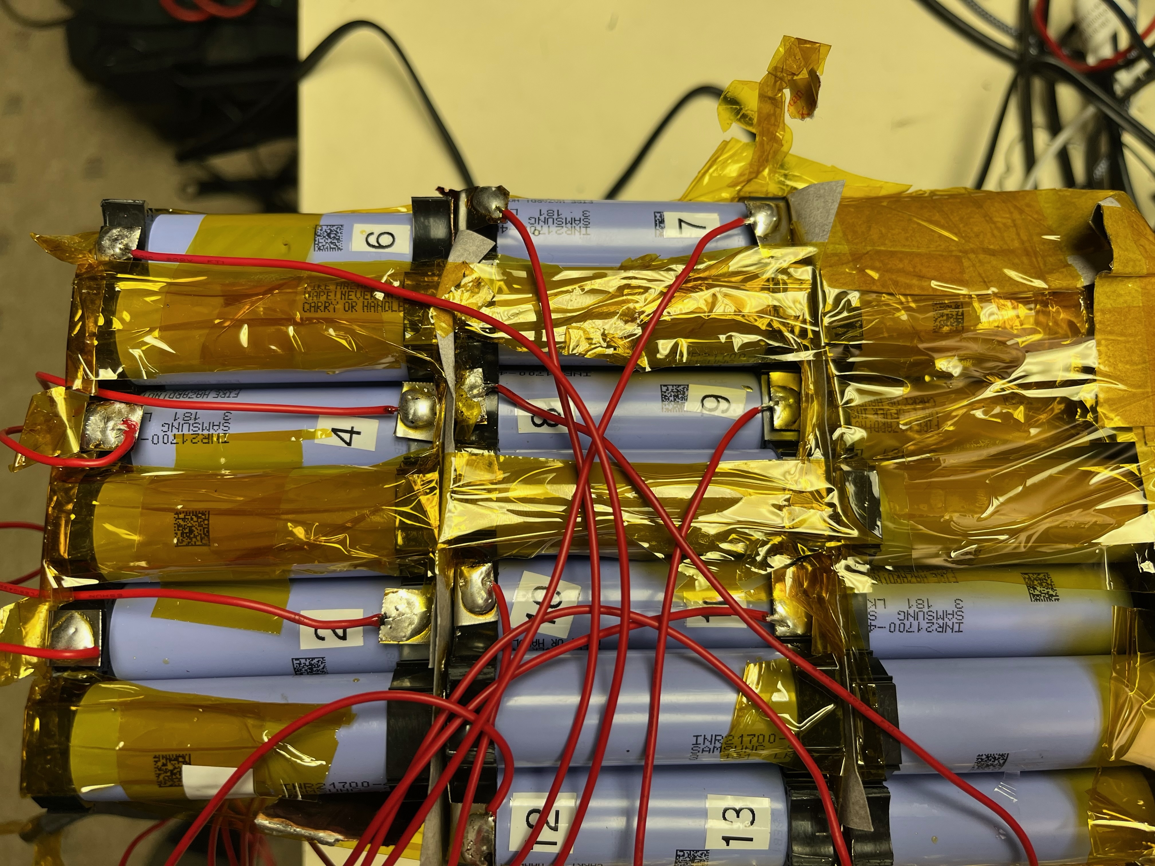

I'm very seriously considering a second battery. I might even just try my hand at building it myself.

Start:
End:
