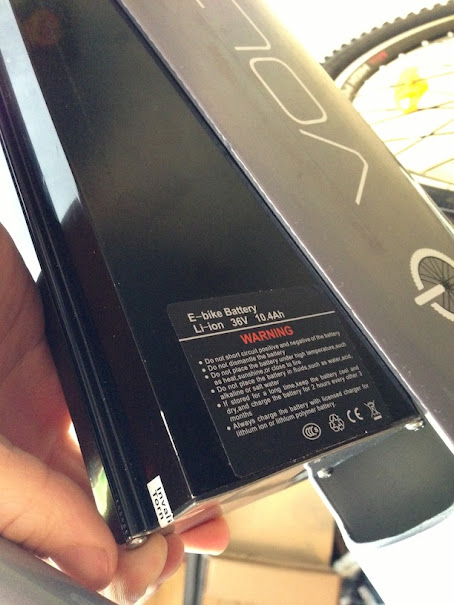

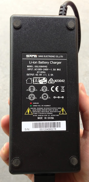

The Alation 350 has a Bafang BPM 350W rear hub motor and a 36V 11ah Samsung battery. I've rearranged some of the handlebar configuration as I've found I prefer the pedal assist control closer to the grip so that you don't have to remove your hand to change it with your thumb. Previously, the bell was in the way--it got relocated to the right side. I also removed the cheap taillight and replaced it with the Planet Bike Turbo 1W. The controller doesn't have a name, but I've added a pic below with some basic info. The charger is also generic and has a small phono connection. Have noticed the pedal sensor is just on the inside of the front chainring. It's pretty good, but takes about an eight of a pedal before it kicks in.
I'll add some more precise measurements and pics when I get a chance. But the standover height is about 30.75 inches from the ground to the lowest point of the toptube and it's 20" from the bottom bracket to the top of the seat post. The seat tube itself is about 18"; however, there's an extra couple of inches due to the larger downtube where the controller is housed. Volton calls it a "medium", but I'd probably call it closer to a large as most people would think of it. Compared to my Cannondale F300 "medium" frame, it's a few inches larger all the way around. Volton currently only offers this size. I've seen many similar frames on Alibaba but haven't seen this exact one yet.
It does look like it'd be a good candidate to use a 24" wheelset. While the existing front fork is designed for the 26", it uses mechanical disks so no issues there. For the rear you'd have a couple of choices--either use the existing motor and build out a new wheel or for not much more order a second motor and build out the wheelset using that so it could be easily interchanged if desired. Ground clearance would become a bit of a concern, so exact measurements are needed, but depending on the tires/rims chosen, you could tweak this fairly easily.
The paint quality, welds, and finish are pretty good but it's still a Chinese-made bike that you'll probably end up upgrading a few things on. I've already ordered new grips, a horn/bell upgrade, and a CREE headlight and DC-DC convertor to work with the new headlamp. The battery and controller are not secured other than by pressure inside of the downtube. I also noticed that there are some sharp edges in there that if not attended too may lead to fraying or other issues. I'll be adding some grommets and tape as necessary to help secure things and make them a bit more durable. I'm not going to be looking into any mods or significant changes as I want to keep the warranty intact. Other than a triangle bag, not much else needed on this one.

Charger:

Battery length:
Battery width:
Battery bottom (I added the bit of foam to help secure it against the controller):
Battery Sticker:
Key and Charger:
