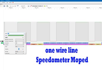

Hi friends, is there anyone here who knows about decoding One Line TX-RX from a single wire of a VOTOL brand controller?
I tested it with a logic analyzer and the results are:
Baud rate: 2000 bps.
Data bit: 7 + 1 stop bit, or possibly 8 data bits with no stop bit.
No parity and LSB first.
data carrier loop: 38 byte data per loop.
Does anyone here have the data Frame formula and decoder for this?
if I know the format data decoder, frame possion, I can use Atmega or ESP to covert with anything display.
Thanks.
Have you tried the example that trufinv posted?.
One-line is only TX.
Or did you mean the RS232 interface?
there's a lot of data in this thread; don't konw if any of it is what you're after:

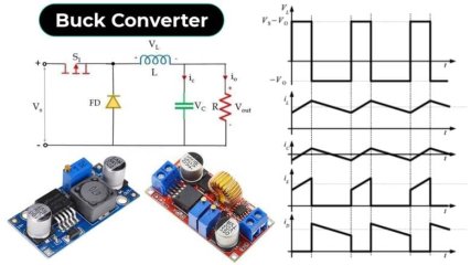

I am interfacing an ESP32 with a Votol motor controller using serial communication (TX, RX, and GND). The ESP32 is powered from the vehicle’s 12V line, which goes through a DC-DC converter and then a buck converter to provide 5V to the ESP32, with a common ground shared with the Votol controller. The issue I am facing is that when I check with a multimeter, the 12V and GND show continuity (beep), which appears like a short circuit, but the entire system is working perfectly, including the headlight, horn, indicators, backlight, Votol controller, and ESP32 communication. Suspecting a faulty converter, I completely disconnected both the DC-DC and buck converters, but the continuity between 12V and GND is still present, which makes me think this could be due to internal circuitry or grounding behavior rather than a real short. However, due to this issue, I am getting garbage values on the serial data from the Votol, even though I have deployed the same ESP32 code on another bike and it works perfectly there, so I believe this problem is specific to this bike’s electrical system. I would like to know whether this 12V-to-GND continuity is normal in Votol or e-bike systems, whether internal components such as DC-DC converters, lighting drivers, protection diodes, or capacitors can cause this behavior, and how I can properly diagnose whether this is an actual fault or an expected condition.
My second question is that I am using different Votol controllers including EM-50-4, EM-50-S, and EM-50-6, and I want to confirm whether the same serial communication packet/protocol is supposed to work across all these models. On the EM-50-4 and EM-50-S, the serial packet works perfectly and the controller behaves normally, but when I use the same ESP32 code and serial packet on an EM-50-6, the controller immediately goes into fault status and stops responding to the throttle input, even though the hardware wiring is the same. The same firmware and packet work correctly on other bikes, so I am trying to understand whether the EM-50-6 uses a different serial protocol, packet structure, baud rate, checksum, or command set, or if certain packets can put the EM-50-6 into a protective or diagnostic mode that disables throttle input. I would appreciate clarification on whether these Votol models share a common serial protocol or if the EM-50-6 requires a different implementation.
The 12V DC-DC converter is good. What you are measuring is a diode connected between 12v and ground.
2 different protocol. Normally the "S" series have uart, the SP series have CAN ( uart protocol over can) also the new model em50-6 have can. If you buy from syacosys, mozt of them have can.
