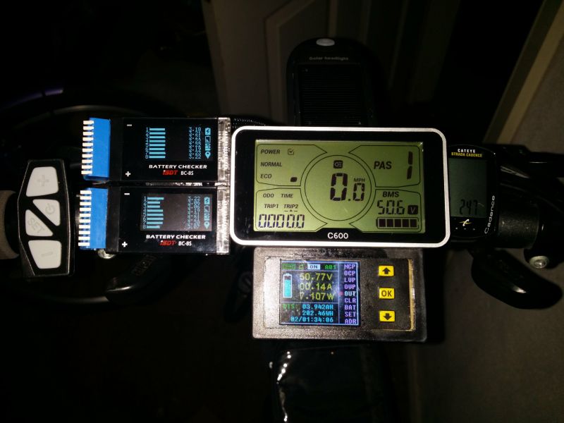

I have received and installed 2x 8s individual LiFe cell monitors, as well as a proper charge/discharge capacity monitor:
As expected, the 2 battery monitors use battery voltage to gauge battery capacity, and show it in a bar graph as well as the actual voltage. These do a good job for that purpose. I have soldered dip switches in-line so as not to cause battery drain when in storage.
I also obtained a touch screen 1-6s LiFe charger for properly charging individual cells:
[youtube]JIXxTHllUrQ[/youtube]
Using this setup, I fully charged the battery pack and ensured balance, and then drained it to BMS automatic cut-off. The charge meter showed ~15Ah of drain at this stage. The individual cell meters showed that indeed the punctured cell at #12 was the culprit at 2.2v with every other cell still retaining good charge of ~3.3v.
Great, so now we know the charge capacity of the punctured cell. But what about the remaining cells, and especially the cell that we replaced at #2?
I then individually charged cell # 12 by ~5Ah, and left the apparatus to drain again.
The picture itself is of the pack about to be depleted after ~19-20Ah total discharge (showing ~4Ah on the drain meter after being cut-off and reset at 15Ah). As hypothesised, the replaced battery #2 is working very well, having been drained the full ~20Ah, as well as, surprisingly, every other cell. The picture shows that cells #10, 11, 15, have the lowest capacity, and will soon cause the BMS to shut down the power supply.
So, through our investigation the following observations and conclusions can been made:
--The original 16s "20Ah" battery pack had an actual charge capacity of ~5Ah due to cell #2.
--Replacing Cell #2 gave us a capacity of ~15Ah, cut short by punctured cell #12.
--Charging punctured cell #12 by ~5Ah allowed a further battery drain of ~5Ah, meaning that aside from Cells #2 and #12, the pack could indeed hold a 20Ah charge.
--Charging voltage does have a significant impact on the use of voltage to indicate remaining charge. Professional charge level indicators are designed to be used to measure the voltage to show the remaining charge as long as all cells were charged with the same charge-voltage. They offer good results, as shown by the 2x 8s LCD screens to the left.
My personal conclusion is that I shall keep an eye on cell #12. If you recall, I had sealed the puncture, so hopefully, further damage has been stopped. If capacity of this cell continues to decline further than 15Ah, I shall replace this cell as well, leaving us with a 20Ah capacity, if and when required.
All in all, we have gone from 5Ah capacity to a 15Ah Capacity by replacing a bad cell at the cost of ~$25. We have also investigated and found that we can further maximise capacity to 20Ah by replacing the #12 cell as and when needed for another ~$25. Of course, this all assumes that the cells won't degrade down the line.

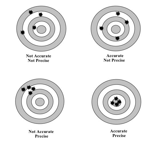

I think you too are confusing accuracy with precision.
I'll illustrate with a diagram:
We are not trying to ascertain charge by measuring voltage alone - this is accuracy, and granted, this might be tricky.
We are trying to ascertain the difference in charge when we know the voltage and charge of one cell, and only the voltage of another cell in exactly the same conditions - the cells are literally next to one another i.e. we are interested in the precision. The 2x 8s LCDs are designed by professional engineers specifically for this purpose and their product works well. It can be argued that it works fairly well even for Accuracy.
Furthermore, above 3V, all the bars of non-defective cells are about exactly the same size and same voltage until reaching the end of full discharge, at which point, of course some bars and voltages start to deteriorate rapidly: cells #10,11,15 as above.
This suggests that the professional electronics engineers know what they are doing, and the product works as per design - If it didn't work, both the bars and the shown voltages would be wildly different compared to one another throughout the discharge cycle. This simply is not true - the bars and voltages are consistent relative to one another, unless one cell is charged at a different charge voltage or the cell is defective. See the above picture of the 16 cell bars and their voltages yourself.
If one wants to argue about the validity of the measurements being out by "somewhere between 80% and 40%" then one would be arguing both with the professional engineers, their working products, and the experimental data as shown above. If you want to argue that, that's your prerogative, and I won't argue with you.
I would however, personally side with the professional engineers and their products which are being used and are well tested world wide, instead of strangers on the internet.

LiFe battery monitors using voltage only:
1. http://www.isdt.co/bc-8s.html
2. http://gwl-power.tumblr.com/page/112
All this from a 2 second google search. The design engineers of these meters are extensively qualified and have far more knowledge than you - I guess the truth hurts :)
1. If the only two people to respond to your writing, both "deliberately misconstr[e]" it in the same way, perhaps the fault lies with the author, not the reader. Not to mention you've confused the hell out of someone else.
2. You've linked a product (BC-8S) that doesn't show state of charge, as far as I can see, only per cell voltages.
3. The product explicitly says that its accuracy is to 5mv. If you look on the table here:
There's less than 5mv difference between 90% SOC and 80% soc.
Not to mention that a 20*C temperature difference can easily account for 5mV difference at the same state of charge:

This will probably be a waste of my time again, however, I'll try to educate you one more time mate:
1. Take any cheap, inaccurate voltmeter with bad accuracy to something horrible like +/-100mV.
2. Now, measure the voltage on a battery 10 times consecutively, and write the readings down.
3. You will note that the reading is exactly the same on all 10 readings, not 200mv out, and in fact not even 1mv out.
In other words, a 1.500v source might read on the inaccurate meter as 1.600v; but dang nabbit, it will read all 1.500v sources as 1.600v.
You know why this is? This is because the meter may not be accurate; it is, however, perfectly precise, as all modern digital electronics tend to be. This is the difference between accuracy and precision.
Now, I know I'll probably lose you at the next step, but here we go: Regardless of the accuracy of the inaccurate meter, if you measure the voltage on a cell and it says 3.300v, and you know that its SOC is 50%. We can measure another identical cell at the same time lying right next to it and if it also says 3.300v, then there is a good chance that it too will have SOC of ~50%.
Understand?
