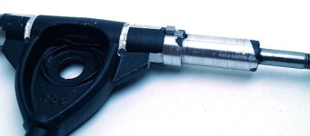

The trucks were prepared much as before, turning them on a lathe in order to get a round profile where the motor fits, and then machining flat spots for the strain gauges. Only in this case we also machined small wire channels in the truck so that the strain gauge wires could be completely embedded and covered in epoxy for full protection:

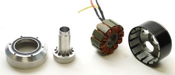

The RC motors are disassembled easily enough, but freeing the stator is a bit tricky. First drilling and then boring out the press fit aluminum support until it pops free, and being careful not to damage any of the phase wires in the process:
And this is at last the free stator which will then be press fit on our own stator support which has a large enough bore to slide over the truck

Weather is great now and we are sure hoping for a maiden voyage at the end of today. Here are all the CNC'd motor parts which we'll soon be pressing together:
