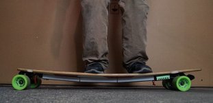

Well guys, been riding around the block all night and we can't get off this board it is so much fun.

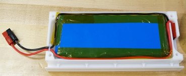

For the battery pack, we assembled a total of 3 of these 10Sx1P batteries from 2600 mAh cells, for a total of 37V 7.8Ah. We made the plastic battery enclosures with an open wire channel that spanned their full length so that we could run all the cables between the front and back of the board out of sight. One thing we learned from the first build was that cable managagement on the under side of a deck can be a real mess, especially with dual motor controllers, strain sensors, parallel connected batteries etc. and hoped to be able to make this one clean from the get go. There are also end-to-end andersons embedded in the housing so that the packs could all plug in in parallel but with the connectors out of sight:
We wanted a long flat battery in order to minimize the side profile of the pack, but the downside of a single large battery is that a board deck flexes quite a bit, and batteries with all their tab welds etc. don't take to repeated bending very well. So by breaking it up into 3 discrete packs the total bending displacement per battery is a lot less. Each pack enclosure has it's own effective stand-off on either end where it is screwed to the deck, and supports the battery with about 3mm of clearance to the wood
This way there is allowance for the wooden deck to flex a fair bit without causing any bending forces on each of the batteries. And jumping on the deck seems to confirm this. There is no loss in board flex from having the packs, and the batteries stay nice and straight while the board springs down
