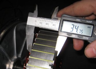

I got a Yuma 3000W motor 72v 40H. What does this 40H Means?
Without seeing the link I believe they're talking about the width of the magnets 28mm,35mm,40mm 45mm and 50mm. Remember though you wider the skater in the wider in the magnets the heavier the motor is.
Its the Chinese method of classifying radial motors. If you lay the hubmotor on its side, in the pic below the 35H number is the "Height" in millimeters.

You have to be careful and see what the axle flat width is because I think the 50h or 55h it becomes wider then 135mm drop out width for normal bicycles. You have to be careful when sellers are vague or advertise watts and dont mention magnet/stator width. I've seen it were they will say its a 1500w motor but its not a 35h motor but its a smaller, weaker 25-30h motor. The Leaf 1500w which is truly a 35h motor. A motor can run on any watts, but its a matter of for how long. People will also sell that 1500w or 35h hub motor as a 500 or 750w to capture North American customers, or list a 1000w 25-30H motor as 250w to capture European customers. They will "accidentally" have a wrong diagram of the motor on their sales website. Thats why you buy from a known entity and not gamble on some unknown seller. People can buy the 5000w 45-50h motor right from mxus warehouse in China, or you get from the flippers or rebranders. QS website is good, but be sure its the official site, many people steal pictures for their own sales website. Sellers have taken pictures from builders on es to post on their sales website, ripping off the OG dudes picture. Uncool.
